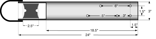

BTW, I came across the measurements for the roller that Catalina Direct carries; I'd downloaded it to my laptop at some point in the past.

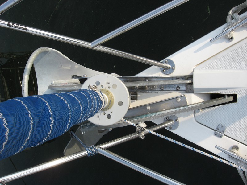

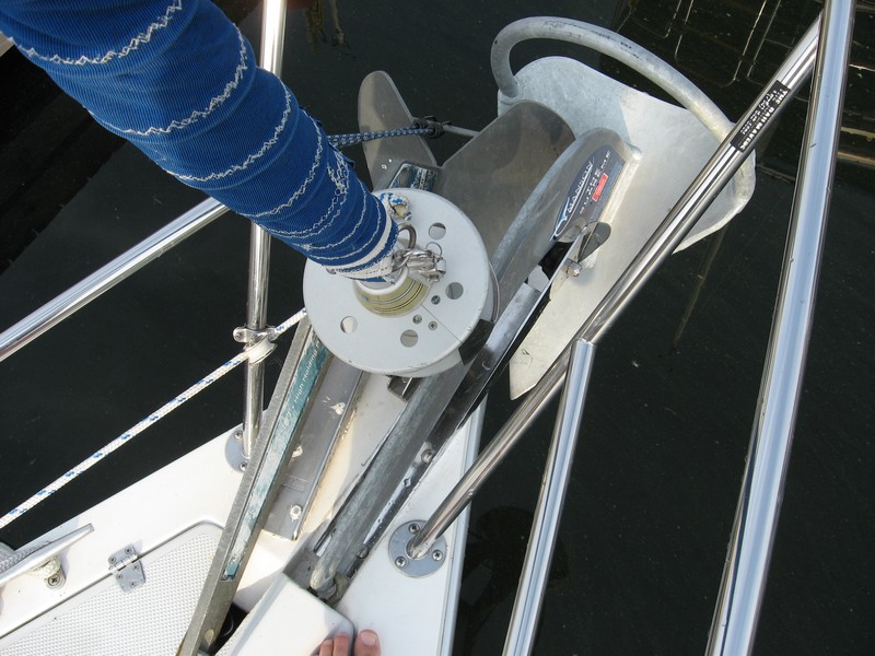

I bought one of those rollers from Catalina Direct because I was having the same problem with the 45 lb Delta hitting the furler. I could get around it by bringing the anchor onto the roller at an angle.
The longer roller does not solve the problem completely but it makes it easier to deal with. I took the short roller off and replaced it with the long one and then I put the short roller on the other side. Now I have a 45 lb Manson Supreme on the long roller and the 45 lb Delta on the short one. There was no wood in the composite under where the stock roller was located, the bolt holes on our boat were missing 1 on the replacement roller so I drilled that through and no wood found. When I drilled the holes for the short roller on the port side of the bow there is some wood in there but it is very deep in the composite and there's not much thickness to it, perhaps 3/8" at most. This area seemed very stout to me. There is so much glass above it that it is hard to do a grind core out and fill with epoxy job on it and with a good flared bolt hole to catch a bead of sealant I'm not sure it's necessary. I had to cut another slot in the anchor locker cover for the shank of the Delta, now I need to make an extension on the raised cover over the original slot to cover this hole, probably that'll be a winter job.
You can see from the pictures that the delta now sits outside the circle of roller furler but the Manson still has the same problem of interference with the furler though it is pretty easy to angle it slightly and avoid hitting the furler. All in all it is much improved though still not perfect. Anchor locker is pretty full now.
The Manson is without doubt the best anchor I've ever used, they are every bit as good as what people say and a lot cheaper than the Rocna. Plus I haven't seen any pictures of Mansons with bent shanks like those floating around the web of the Rocnas with a 90 degree bend in the shank.

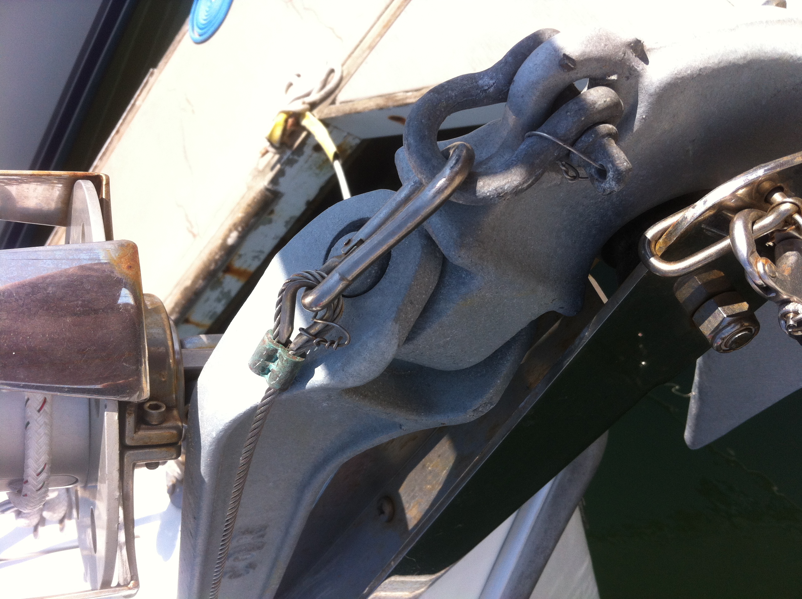

I too suffer from this problem. The way I deal with it is I have a cable and line about 4 feet long attached to the anchor trip hole. I use this line to lift the anchor off the roller while standing straight up. I also use the line to retrieve the anchor. Works ok for me.

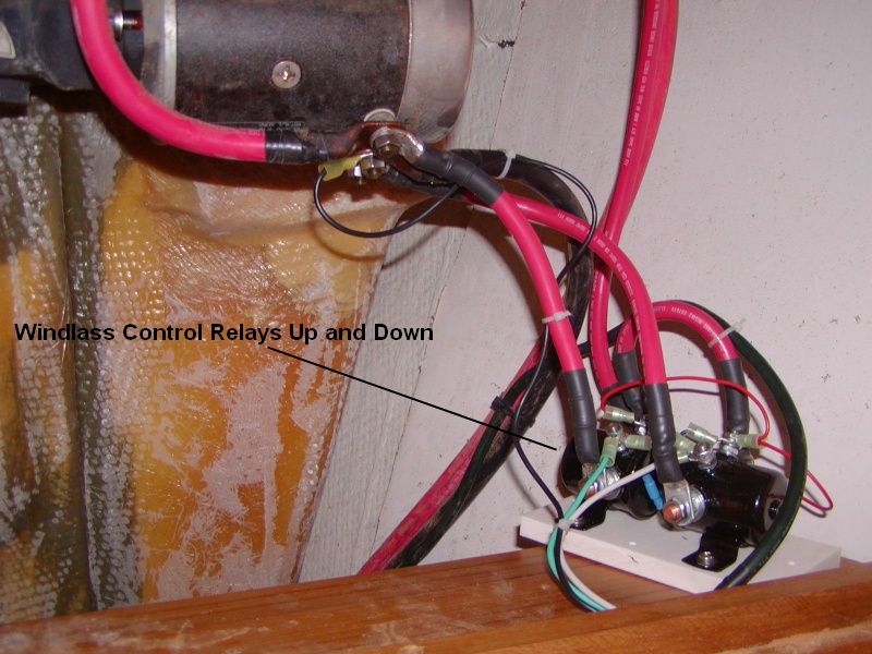

Here is my solution to avoid anchor-furler collision. It is home made but works well.
Also I added these 2 relays to remotely control raising and lowering the anchor  - it is wired with up/down switch.
Nice idea, Haro, the roller above the anchor shank.
