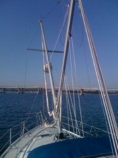

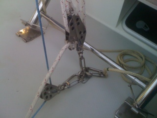

I recently purchased this boat and briefly mentioned this set up in another thread. There seemed to be some interest and questions regarding this set up, so I thought I would take a couple pictures and give a brief description of what I have.
I am not a writer, photographer, or even a sailor. I have very limited knowledge of sailing, the terminology, or this boat, but here I go.
I believe that this boat was originally keel stepped. It is now deck stepped, with a compression post. This was not done by the manufacturer. It was done by a local rigger.
Boat has in mast furling, but TM can be done on a traditional rig.
Tabernacle masts are not that uncommon in this area, but most are done on C30s. I have seen them on a 34, 380, 400, and even a 42. The 42 presents a whole different problem because of the swept back spreaders.
I have an axle that goes through the base of the mast that it pivots on. It is just forward of center, and mast lowers to the bow.

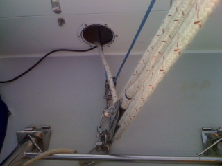

Mast can be lowered by an electric winch mounted in the port lazarette, or by a manual block and tackle set up.
The winch cable comes out of the lazarette and attaches to a pad eye by a turning block. The pad eye is located on the floor of the cockpit under the table, which tilts to the starboard.
Winch cable then attaches to the end of the boom. The block and tackle also attach to the pad eye and the boom. I believe this is mainly for safety in case winch cable breaks. There is also a safety limiter cable that is attached too. The safety limiter cable is measured to the exact length to allow mast to clear both the local bridges.
The rigger told me he designed the mast to be lowered all the way to the deck, without the limiter cable attached.
A bridle attaches to the back of the boom, and then forward to both of the middle lower shrouds.
Both the lower aft shrouds and back stays have quick release piston pins. When these are removed, you just push the button on the winch control, and the mast is lowered.
I have only done this once when I took delivery, but I was singlehanding, and it was real easy.
I hope to go out this Sunday, and will try to take a couple more photos of mast being lowered.
Last picture is proof of the easy one finger operation.

OOPs, guess I forgot this picture.
I'll have more this weekend.

Kind of got served on my inaugural sail, but that's another story.
Here is the mast in the down position, getting ready to go under a bridge.
