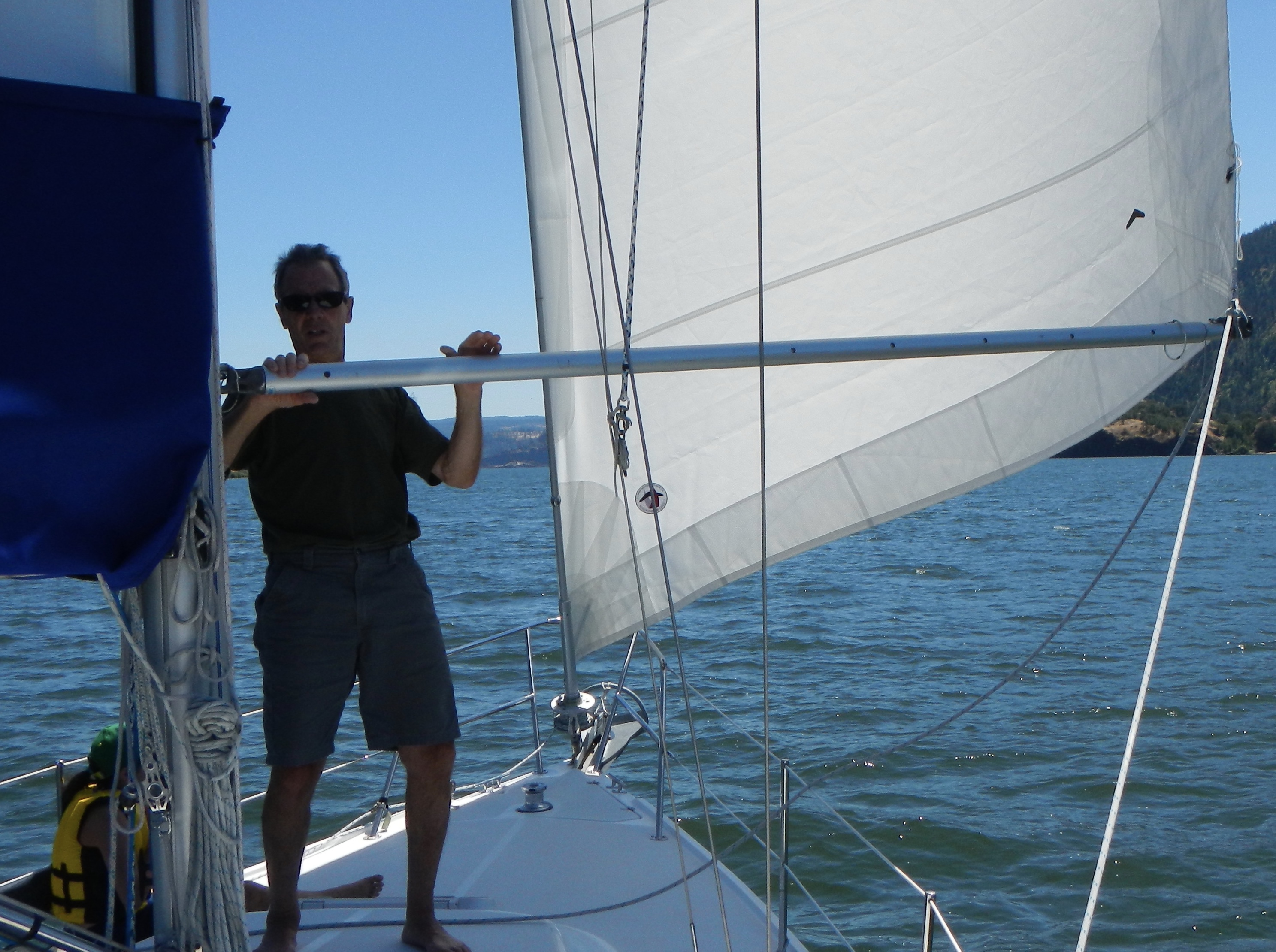

Most of my experience is with a Spinnaker and Spinnaker pole. We’ve been using a Whisker Pole for a couple years so I’m sure there are others whom are better qualified to answer this question. This is simply how we are doing it……
Our last boat came with a Whisker Pole, without support lines that would commonly be used with a Spinnaker Pole. So, I used the pole as set up by the previous owner. Simply, one end of the pole is on the mast track and the other on the Genoa clew.
Sheet the sail, pulling it back to the foreword intermediate shroud. At this point we are done. Sail tension and gravity pulls the sail foreword keeping the pole in place. If you were worried you could use the lazy sheet to provide tension that would help lock the pole in place. We don’t do this and have sailed with this configuration with TWS in the high 20’s. It has been rock sold without a problem.
Jibing is super complicated. Turn down wind, ease the sheet and pull across with the lazy sheet. Done. Too much sail out, pull in the roller furler line. Done.
Although some caution is required that your pole is not extended out far enough that it will touch the forestay. We run a small headsail so this is rarely a problem. If you run a headsail larger than 100% you will probably need to take some action prior to jibing. E.g. Shorten the pole. Dip the pole, Remove the pole thenreset as you would a spinnaker.
I attached a photo taken earlier this week. Our good friend Nate setting the pole height on the mast.
