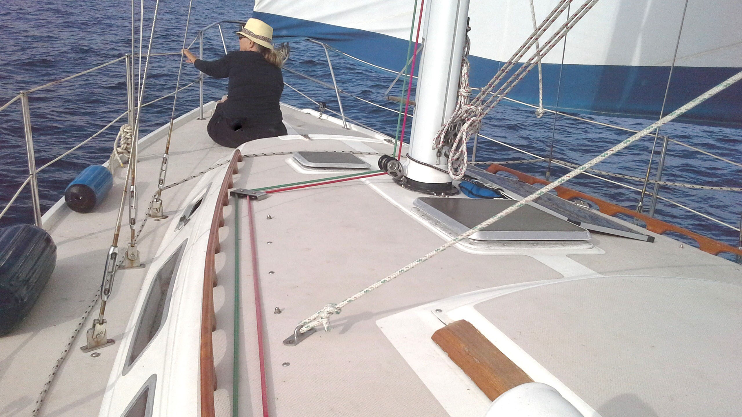

The red halyard comes out of the mast 2 feet below the green halyard which raises my main sail. I cannot see where the heck the red halyard goes once in the mast. It has no contact with the jib. I've attached a photo showing the red and green halyards running from the cockpit to the mast.

If I interpret what I see in the picture you supplied correct, my first assumption the red line is your halyard for the Genoa. You don't see the end as it is up at the top (Head) of the sail with little exposed for viewing. As you appear to only have two lines running down your port side deck and in this picture it does not appear there are any lines running to the turning block and deck on the starboard side. What I am not sure of is what the line (white with red flecks) on your starboard side of the mast and cleated off is for. Do you know where the other end of this line is, and what it is used for? It could be the halyard for the Genoa or it is a spinnaker halyard or spare halyard either exiting the front or rear of the mast and attached somewhere visible.
My boat appears to have been setup so that the Main halyard and the Mainsheet are on the starboard side and on the portside are a spare jib/Genoa halyard, spinnaker halyard, and the jib/Genoa halyard.
Based on your questioning I assume you either bought this boat all setup or you don't get involved with  any of the rigging. If the white and red flecked line is in fact the halyard for the Genoa and you do not see any sign of the red line and it's end than I would assume the end is right at the top of the mast and useless until you have someone bring it down. If you have both ends of the white and red flecked end accounted for another purpose than the red line is the Genoa Halyard. To prove this on a calm no wind day unfurl your Genoa and release the red halyard ( you might want to hold the halyard as you release incase your Genoa should immediately fall to the deck), go forward and gently tug on the Genoa while someone is holding the red halyard either in the cockpit or at the mast. If the red moves while you tug than you know that is the Genoa halyard.

Where the halyard runs on the deck has little or no bearing on what it's for.  Also, where it comes out of the mast at the deck is of little importance.  What you should do it to look at your masthead with a pair of binoculars and find out where it exits up there.  If you use the green halyard to raise the main, then it should exit the masthead over an aft-facing sheave.  If you use the blue halyard for the jib, then it should exit the masthead over a forward-facing sheave.  If the red halyard exits the masthead near the blue halyard, also on a forward-facing sheave, then it is a second jib halyard.  If the red halyard exits the mast a few feet below the top of the mast, on the stbd side of the mast, then goes up to an external block at the masthead, it is a spinnaker halyard.  Hope this helps.

I don't see the working end of the red halyard in your pic. Where is it attached at the moment?

Based on your photo and they way my boat is set up the red line is your mainsail reef line.  If it disappears look to see if it does run into your boom and then through your mainsail.
