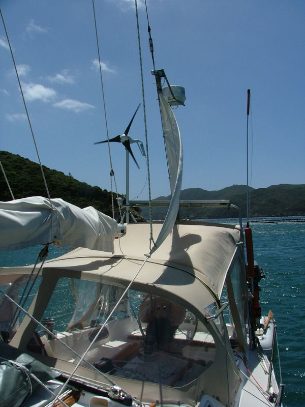

Ours is a bit larger and built for storm force winds - in case we have to use our parachute anchor in more than 30 knots...
We hank on the back stay, have a cheek block on the radar pole (Main halyard would work fine) and lead a sheet forward [I]and to one side[/I] resulting in a bias to one tack. There is a downhaul on the bottom corner also.
This bias is meant to keep the 'sailing thru the wind' to a minimum. Works reasonably well could supplement the bridle idea above. If you can stay on one tack the sailing is reduced a lot. As rigged I estimate wandering is reduced by 60% or so, going by the GPS track at anchor, without a bridle. We've used it in 25 to 30 knots.
The photos show the boat riding one way then the other. The main halyard is pressed into service here to prevent the sheet rubbing on the dodger. I intend moving the cheek block higher up the back stay to tighten the top of the riding sail, and keep the sheet clear of the dodger without the main halyard...
If I had a split back stay I would definitely try attaching to one side.

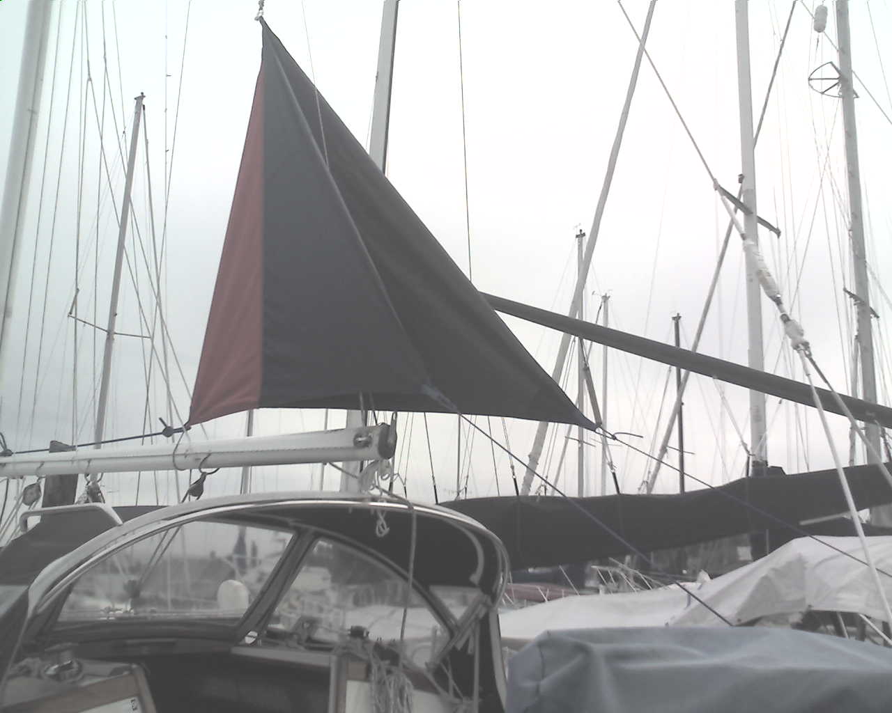

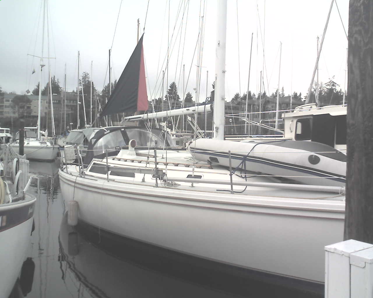

I liked both the Sailrite and Findelta sails. Sailrite has a good video on their website on the details of making their kit and it would be fairly easy to put together and priced well. I watched the video several times and found it very helpful. The Findelta seemed like “the next generation” kind of design and its concept more aerodynamically effective than just a single panel. Plus the split backstays would not be an issue. I had some heavy coated rip-stop lying around so began conceptualizing. I got some red awning cloth from the local fabric store to finish the front fin, as well as basting tape. It’s been many years since I’ve sewn and I found basting tape to be a wonder thing, no more pins! It’s an intermediate project, beginners be advised, but good experience too. Sorry, I haven’t tried the sail on the hook yet but it hoisted nicely. The sheets attach to either the stern cleats or pulpit. It’s heavy enough to withstand a significant breeze. I have about 10 hours and a $100 in it. I’ll let you know how it works.
