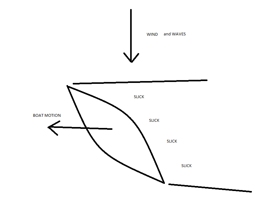

Stu's comments are good. What can make it confusing is the difference between the HEADING versus the COG (course over the ground) of the hove-to boat. I like to draw diagrams of the wind direction, boat heading and approximated boat motion (both forward and athwartship relative to the boat's heading) to visualize this.
Perhaps some would like to comment on the simple sketch and if it agrees with your observations. I have never had to heave-to in our C36, but have done so on several other boats of similar size.
It is impossible to heave to without some amount of motion. This is because the heaving to is, by definition, a balance between headsail aerodynamic drag and rudder effectiveness. It's a minimum amount of water flow over the rudder, that's true, but that's what balances the boat. No water flow over the rudder, no heave to.
