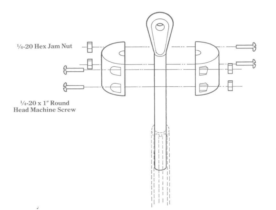

I also had an issue with our Hood Seafurl jib furler turning hard two years ago - drum and halyard bearings were fine. Discovered the top clamp screws had come loose and the clamp was rubbing on the extrusion as it turned. Lifted the clamp and tightened the screws and the problem was solved.
