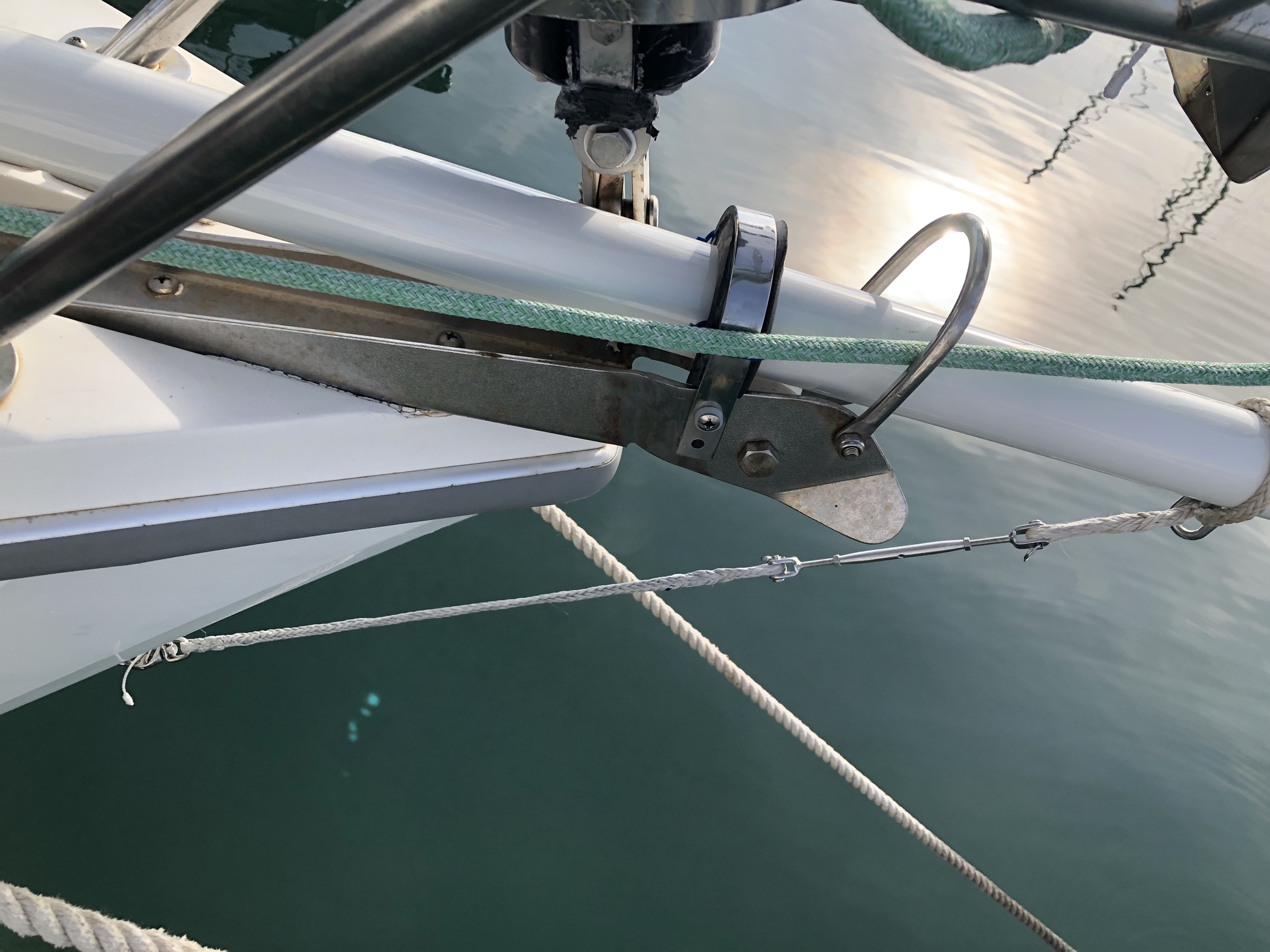

Have a look to bowsprit https://trogear.com/ it might solve your concerns. We do sail with a A0/3 (close to Code 0, but with a wider angles use)
personally, I will not consider a Code 0 a downwind sail. In our boats with a 150 genoa is bigger enough as head sail in the breeze (if you do not race) I will go for a more versatile downwind Like an A1.
I manufacture myself, a small carbon bowsprit and works lovely, we added a Bob-stay.
Just a thought

I understand your concerns of having de anchor ready for use. We have a spare one in the after locker ready for use and the carbon bowsprit is so light that can be removed in seconds.
honestly I do not think, specially in light conditions that a Code 0 (laminated cloth) will work from 60-135 TWA. My thought is that a A1 will perform much better on the conditions you are looking for.  We sail our A1 from 70-130 TWA, discuss with your sailmaker, I'm sure he will give you the best advice for what you are looking for.
A modification you can do, instead of a bowsprit, is to weld the arch on the anchor soport, in a fix position so the pulpit is free (sorry for my English) and use it to attach the tack. I have use this arch long time an it works! You can even weld a longer arch to attach the tack, it is simple and cheap an it works!
