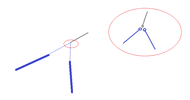

I used a 3 Part splice where each sheet will be independent from each other as well as the strop. That way if something goes wrong, you are not compromising the whole sheet. The sketch will give you an idea.
NEREEU38 New England Ropes - Endura Braid Euro Style - Solid Color 3/8 in. - 10 mm.
Color: Blue
MPSSPL113 Spectra / Vectran Single Braid Eye Splice
MPSSPL115 Jacket Splice for Stripped Rope
MPSSPL106 End Whipping
NERE12316 New England Ropes - Endura 12 - 3/16 in. - 5 mm.
TYLS8 Tylaska S8 Spool Shackle
The use of eye splices make the sheet, yoke and spool shackle easy to connect. The tapered sheets, yoke, and spool shackle greatly reduce the weight on the clew of the asymmetrical spinnaker.

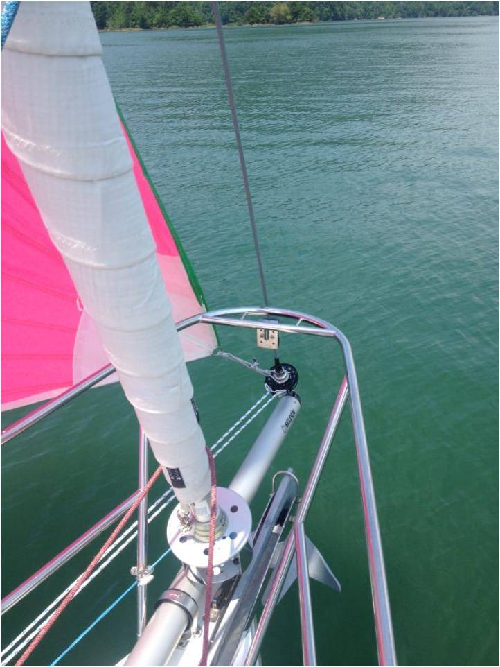

I also installed a Selden removable bowsprit and a Selden GX top down furler for my asymmetrical spinnaker. Now it is easy to handle the spinnaker short handed.
