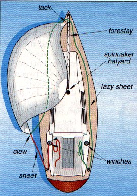

2. Unless your spinnaker is pretty small across the foot, you want the turning block to be pretty far aft, so I am not sure the outboard Genoa tracks are the answer. Rather than leading the spin sheet through a car, you are supposed to have the sheet run far aft to a turning block and then forward to your winch. In our boats, we have to use the primary winch.
See image I got off the Internet.

Interesting. That image makes it look like I could use the existing jib turning blocks, without any need for a track. Certainly makes the system about $150+ dollars cheaper.

[QUOTE=FlyMeAway;17614]Interesting. That image makes it look like I could use the existing jib turning blocks, without any need for a track. Certainly makes the system about $150+ dollars cheaper.[/QUOTE]
Not quite, David. The cheek blocks on my 1999 model are angled with the coaming and the spin sheets will certainly chafe on the cheek plates. What I did (posted before with pics, I believe) was to install a sturdy padeye on top of the cheek plate (using the center bolt for the sheave for one side of the padeye and another carefully located bolt to avoid interference with the sheave and Genoa sheet). I attach a swivel turning block to the padeye and reeve the spin sheet through that to the primary Genoa winches. It works great.
It looks much like the image I posted.
Try this link for the orignal post with pics: [url]http://www.c36ia.com/forums/showthread.php?t=584&highlight=padeye+cheek[...

Interesting layout.
In thinking about this, will there only be a problem (with using the tracks) if I want to use the asymmetric on relatively upwind points of sail (the diagram you sent looks like proper trim for a beam reach)? I'm thinking of flying the spinnaker on a broadreach only.
I think it does answer my question, though, about the kinds of track blocks I would need -- much better to have a swivel block (is there a more technical name for this?) rather than the track car.
This isn't for racing. It's for cruising. Given the prevailing winds on Puget Sound, a fast downwind leg home means more time hanging out in the San Juans.

Well, David, if the kite clew will always be flying fairly far forward due to deep wind angles, then you could probably get away with running the sheet through some block on the outer track. You still need to ensure that the angle of the sheet from the block to the winch drum is appropriate so that you do not get overrides.
FWIW, I have seen sailors attach swivel blocks to their stern cleats. I am not sure if you would have a fair lead from there to the winch. I know that I have way too much gear in the way.
Another thought, if not racing and only sailing broad reaches, you may not need a tack downhaul at all. If in that situation, I often just let the ATN tacker slide up the furled headsail until it stops at the Genoa sheets. That is a good height for my tack and the size of my asymmetrical. Yours might not work that, but at the least, you could get away with a fixed pennant and not need to rig an adjustable downhaul.
