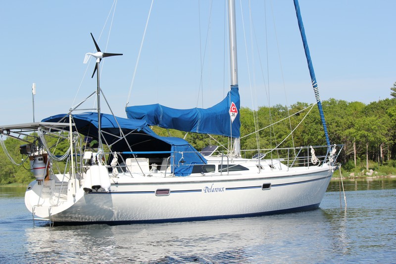

I am interested in seeing/hearing more about your wind generator. Do you have any pictures of the installation? We are contemplating getting some sort of battery charging array, whether solar/wind gen, or both..

I am interested in seeing/hearing more about your wind generator. Did you install it there, or somewhere else? Do you have any pictures of the installation? We are contemplating getting some sort of battery charging array, whether solar/wind gen, or both..[/quote]
Attached is a photo of how we mounted the wind gen and solar panel. It's a 220 watt panel and between it, the 200 watt wind gen and our normal 1 hour of motor running with our 90 amp alternator to get in and out of anchorages every day we are fine for power. Also have a 2 Kw gen but haven't needed it yet. But we are careful with power and our fridge has had additional insulation added so the compressor only runs 1/3 of the time.

Nice looking.. is the wind gen and support rods outside the life lines? Were the mounts provided with the wind gen?
Our Edson davits are much lower than yours (waist high when standing in the cockpit), so we were thinking of putting the solar panel mounts above the bimini.
How did you route the wires to the battery? Any schematics and/or configuration?

[quote=rtrinkle;15289]Nice looking.. is the wind gen and support rods outside the life lines? Were the mounts provided with the wind gen?
[/quote]
Main mount is inside the pushpit through the seat and it's bolted to the railing. The starboard support rod is inside the lifeline, the aft one is parallel to the railings. Southwest Windpower makes an rubber insulated mounting hardware kit and I got that but the entire mount itself was custom built by a SS shop, it also is our outboard motor lift.

That's a good plan as well, Duane Ising, the C36IA Commodore has his mounted in both places. We get more power from the solar and it is totally quiet, the wind gen is much quieter than old ones but it would be foolish to say you won't hear it. You will and if you are an aft cabin sleeper or a light sleeper it will bug you. I don't mind the sound but my better half disagrees, so we never run it at night. Solar won't keep your batteries charged when it's cloudy, so I hedged my bets with both. We wanted the davits high to use the swim platform without having to lower the dinghy for a swim, plus to keep it out of the water when heeling.

There are conduits in the aft cabin. Look inside your aft cabin hanging locker on the aft side, you will see several conduits, they come out in the starboard aft lazarette. Quite easy to snake wires through there. Try to keep the 12V and 110V runs separate.
