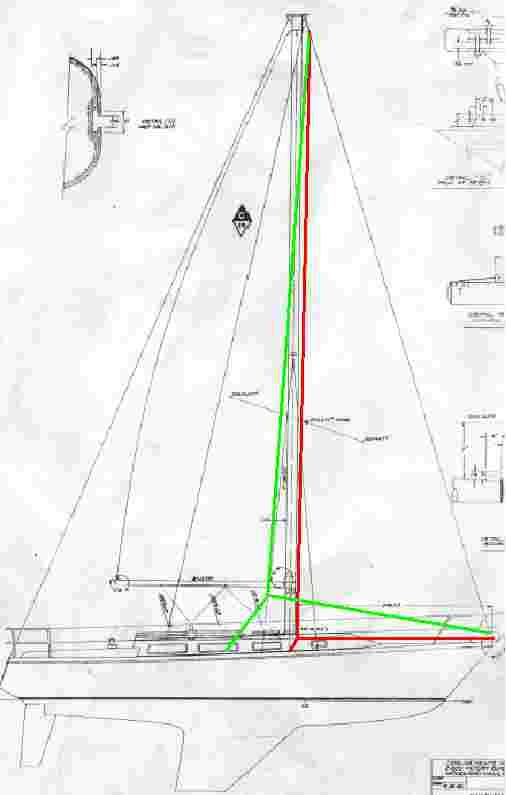

You can easily get a 100% jib to lead to the existing tracks, just have it built with a higher clew. My previous boat, the 100% actually sheeted further aft than the 150%, because the 150 was a deck-sweeper and the 100 was high-clewed. This also helps with visibility to leeward when you are heeled, which you ought to be when you are using the small jib. Not the raciest setup in the world but a heck of a lot faster than using a half-rolled 150% genoa and your genoa will last a lot longer as well.
Attached pic shows two 100% jibs of approx same are, red a typical race boat low clew style, and green a higher clew which you can see would lead back to the existing tracks.

Nimue,
My 110 too has a high cut clew, yes the racers on the bay call me clewless but, it works well on S.F. Bay. If going upwind I usually put the first reef in the main between 20-25 kts going upwind, by 30 kts it is time for a second reef or rolling up the head sail a bit. Sheeting angle has not been a problem. Better than being over powered with a large head sail.
Sheeting angle is what landlubers call excessive heel, the boat leans over so much they are ready to Sheeeet.
Not being a racer I have considered about a 90% head sail on a self tending system for decadent lazy sailing.

The higher clewed sail will also set better on a reach. No reason to add forward tracks to our boats really.
A cheap option for a smaller sail is a jib off of a 'non-overlapping' style race boat. A 1D35 heavy jib sets around 90% on a std rig C36, and a J/105 jib sets around 80%, which I would consider a #4 jib. These sails might not lead back to the existing tracks so well without a recut though.
