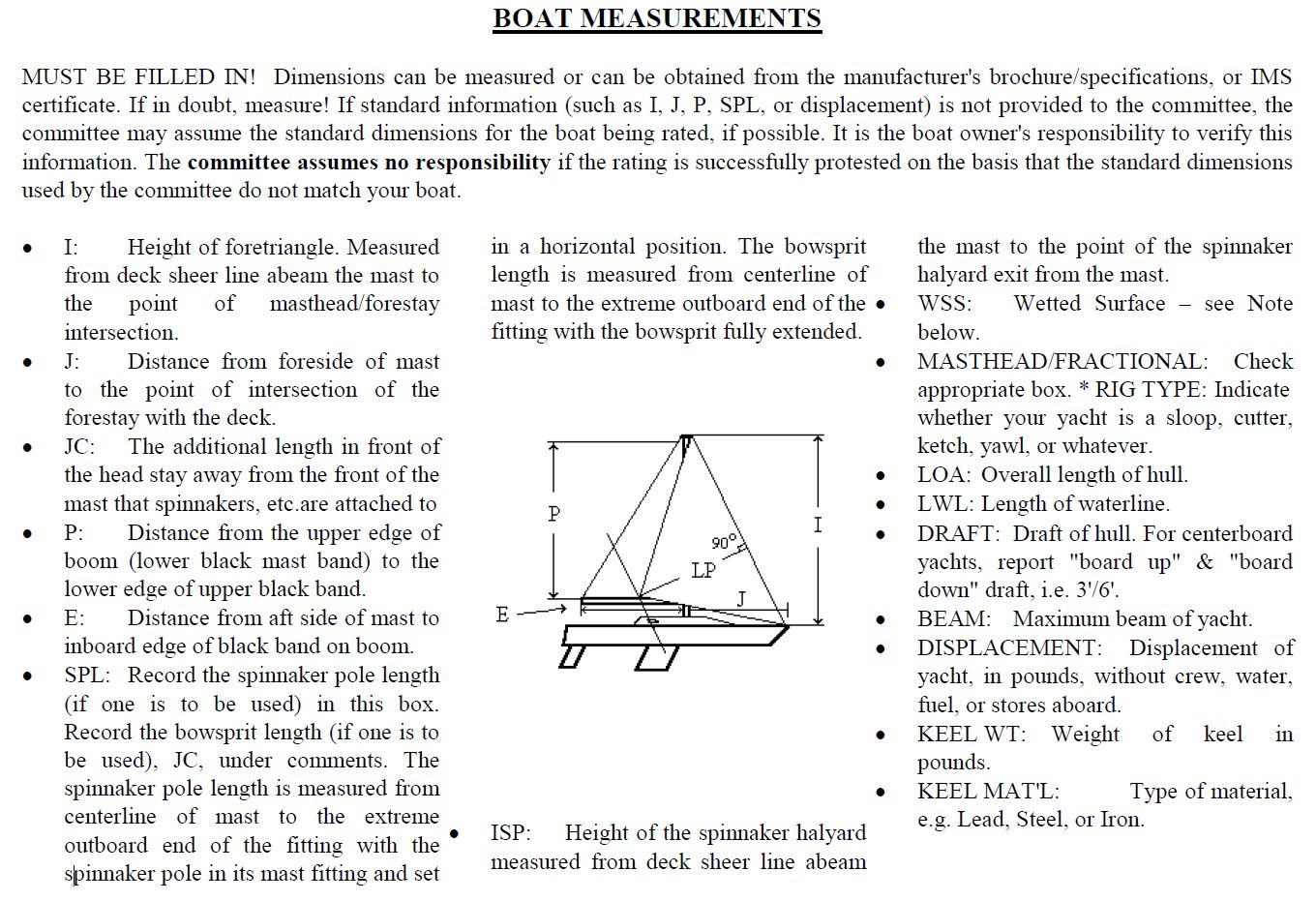

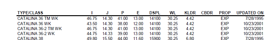

Here are some of the critical dimensions you are looking for: The rest of the information should be found in the Members section the technical articles. Here are the base ratings for your boat based on several areas.
