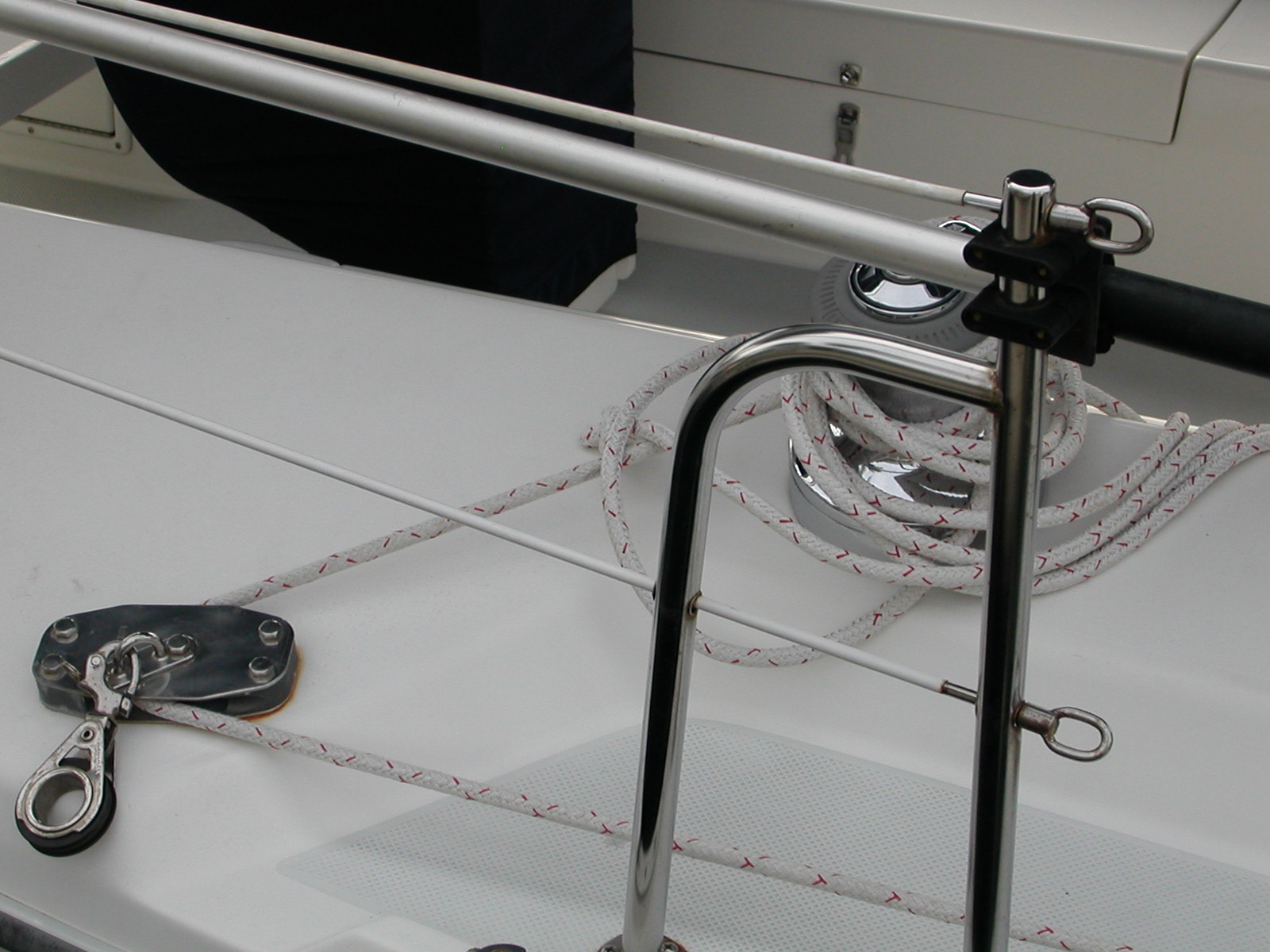

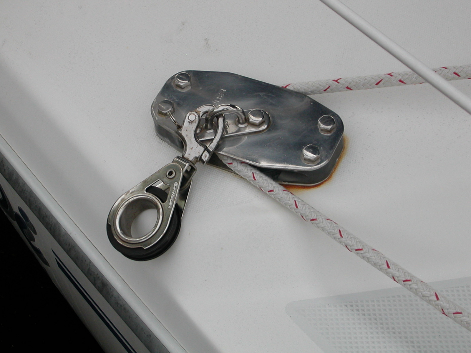

Here is my solution to rigging the spin sheets. One side of the padeye uses the existing center bolt on the cheek block. The other side I drilled and used a machine screw and nylock-nut. You just have to be sure the nut isn't in the path of the Genoa sheet.
Finally something the mk 1 does better than the II - our spin sheets can just go on the toe rail track which extends right to the back of the boat.

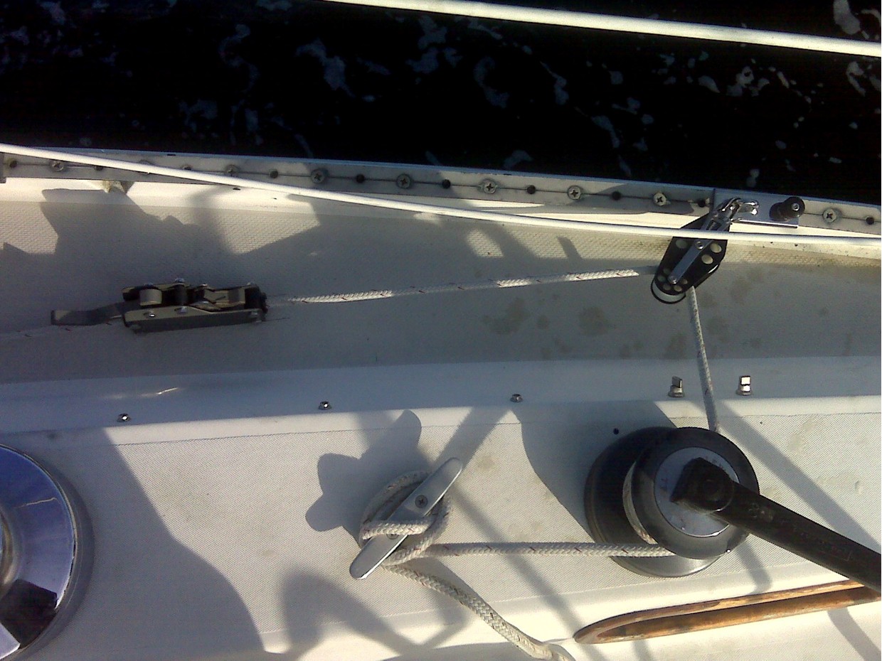

I use a fiddle block where my mainsheet goes to the secondary winch, the kite sheet just goes through the lower sheave on this block, top right of the attached pic (and to the same winch). Also if I need to do a spinnaker peel, I can pop the mainsheet out of the upper sheave (with the clutch closed) and put a changing sheet through there. Simple.
