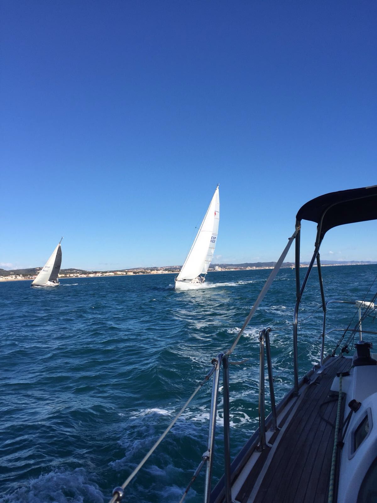

Hi,
Usually race single handed, I set an inner stay to fly a 30sq m Solent Yankee, and a 12sqm storm jib when the wind starts to built up. Until 20 kn AWS we use the furling system from facnor Fd, which has a racing luff profile and a extremly low drum, were I fly a 145 genoa.
Note, in the attached picture, you can see Eureka flying a 30sqm Yankee on the inner stay.

Do you have some pictures how your inner stay is set up?
Do you use dyneema?
What is your halyard setup for this inner stay?
