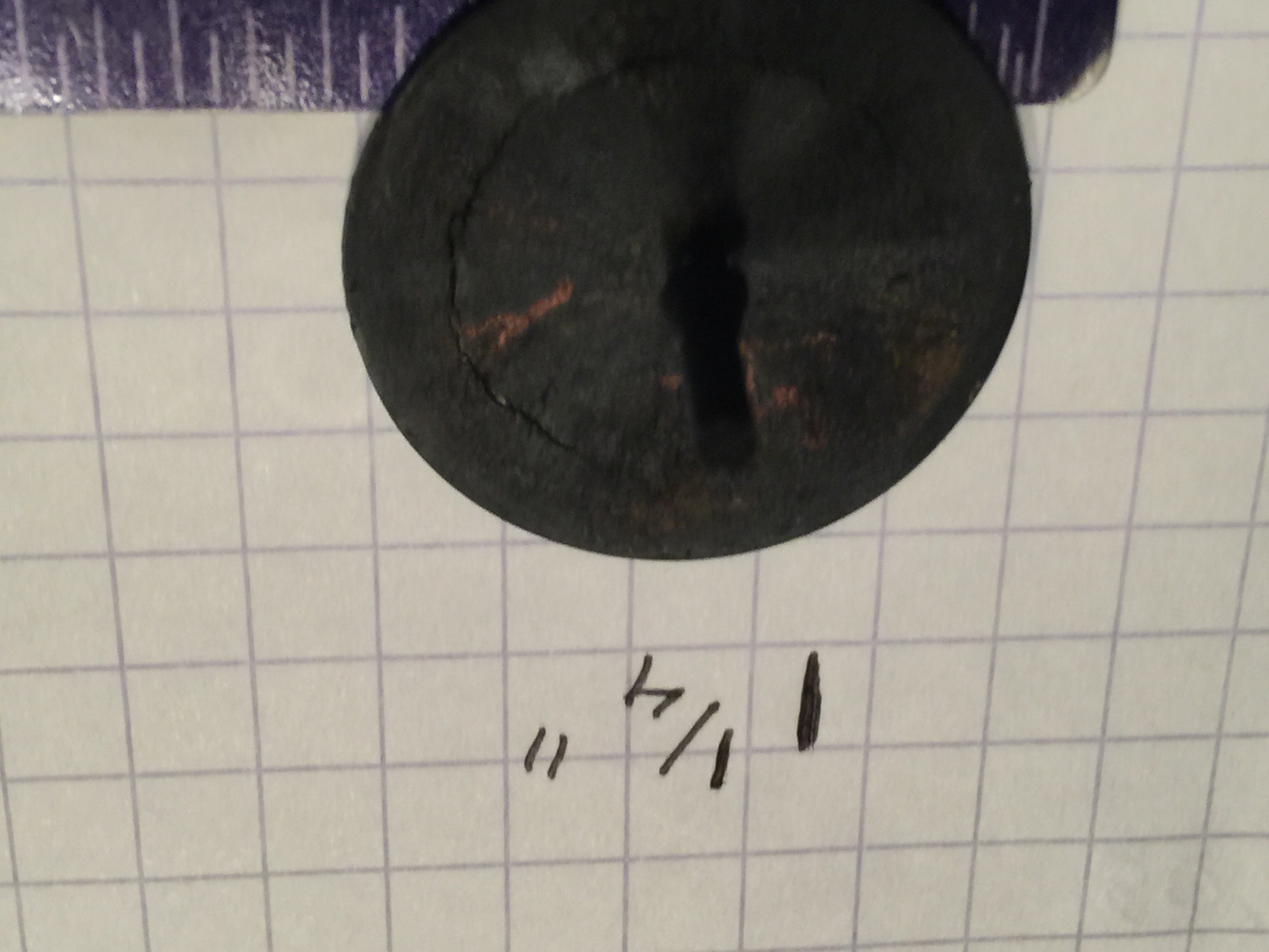

The solution:   Transom board & respective hole the sleeve fits into (from back to front were in excellent shape and clean.   I used a two part epoxy, Power Poxy Marine epoxy, to glue the sleeve into transom, then rimmed both inner and outer transom sides of sleeve with aquarium silIcone (because I had some on my peg board).   When I looked at the rubber diaphragm ( see picture) could tell it had small cracks and needed a $6 part, available from Zodiac dealer.  Should be good for a few years.
