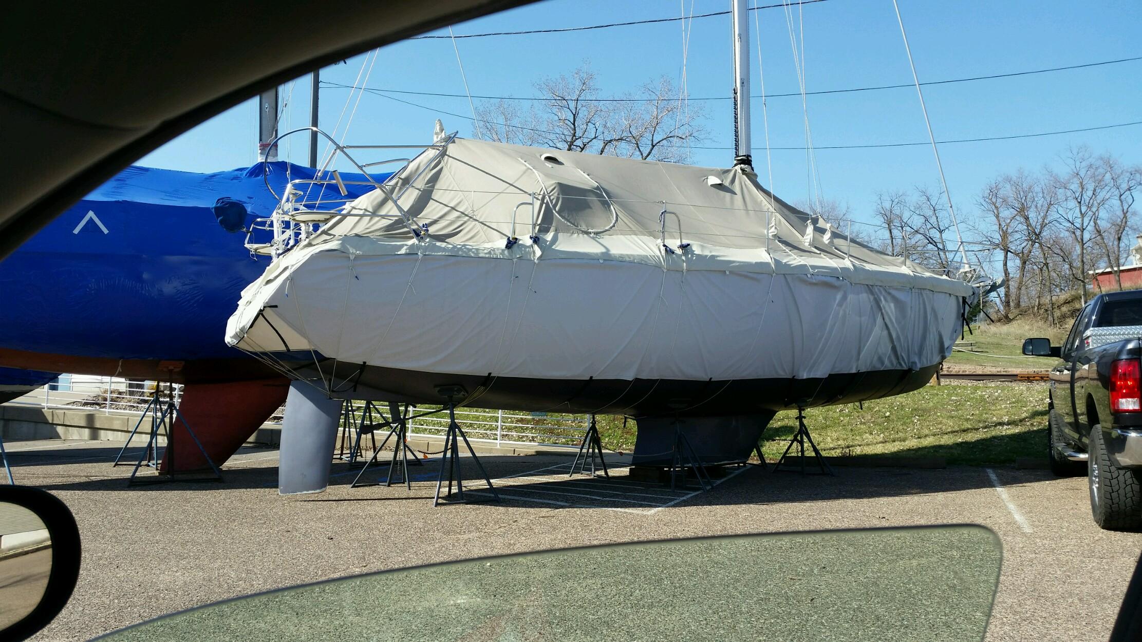

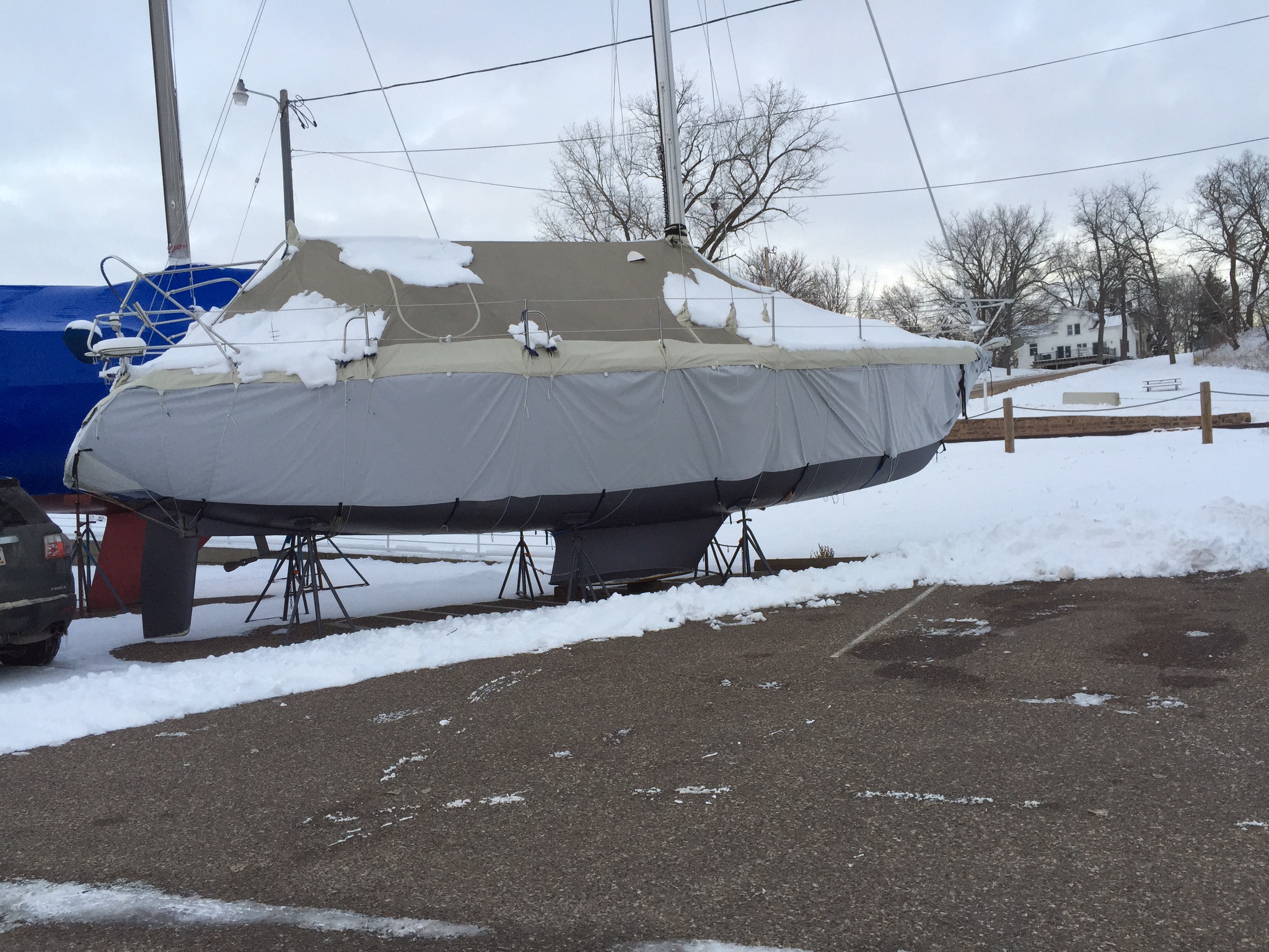

We sail Pente on the upper Mississippi River, Lake Pepin, 75 miles SE of Minneapolis.  January - February temperatures get as low as -25 to -30 F.   Boat is stored on jack stands outdoors.  In previous years I have always winter stored sails at home.  This year am considering leaving the jib up, very tightly furled. Main sail might be stored on the boat.  Jib is original to the boat (15 years old), blue sunbrella cover is in good shape.  Sails had minor repairs done last winter and both are in excellent shape.  I would leave multiple wraps on furled jib so it wouldn't become lose.  We have never had issues with rodents getting in boat.
​Any really strong reasons why not go through the effort and ritual of taking down jib and storing sails in doors?  Pros:  Save lots of time in the fall and in spring commissioning.
We had a two piece "skirt" wrap (zips together at the bow) made cover toe rail to waterline.  Also had cover made for walk out transom.  Both keep hull clean over winter and by keeping snow off walk out transom reduce incidence of moisture gel coat cracks from growing).
