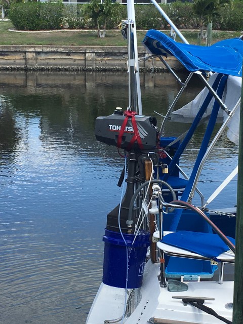

 We use a 2 stroke Tohatsu 3.5 HP outboard to push a nine foot Hard Bottom Inflatable (HBI) around the harbor. We also use a Garhauer outboard motor crane to mount this light engine on the Catalina's rear pulpit rail and dinghy. It is certainly not the fastest dinghy in the harbor but, at 38 pounds, it may be one of the most manageable.
First, I think horse power of the required engine has much to do as to what type of dinghy you wish to push. An HBI or solid bottom type tender will be usually be easier to push through the water than a soft bottom inflatable and thus, requires less horse power to so.
Our 9 foot Achilles HBI is rated for up to a 9 HP, but moving and mounting a 100 pound 4 stroke engine would seem more trouble than the extra speed  is worth, even utilizing the motor crane.
The new 4 stroke engines are even heavier than the older (now illigal) 2 stroke engines and, of course, once you go over 6 HP, you will start into two cylinder models and again, add more weight.
Just for kicks: a five gallon pail of water weighs about 42 pounds. Fill one up and try moving that around the transom area to get an idea of what it would be like at double that weight.
So to conclude, I'd say weight is an important consideration and perhaps one that can be placed above speed.
Pictured below is how we rinse the salt water out of our little engine.
YMMV

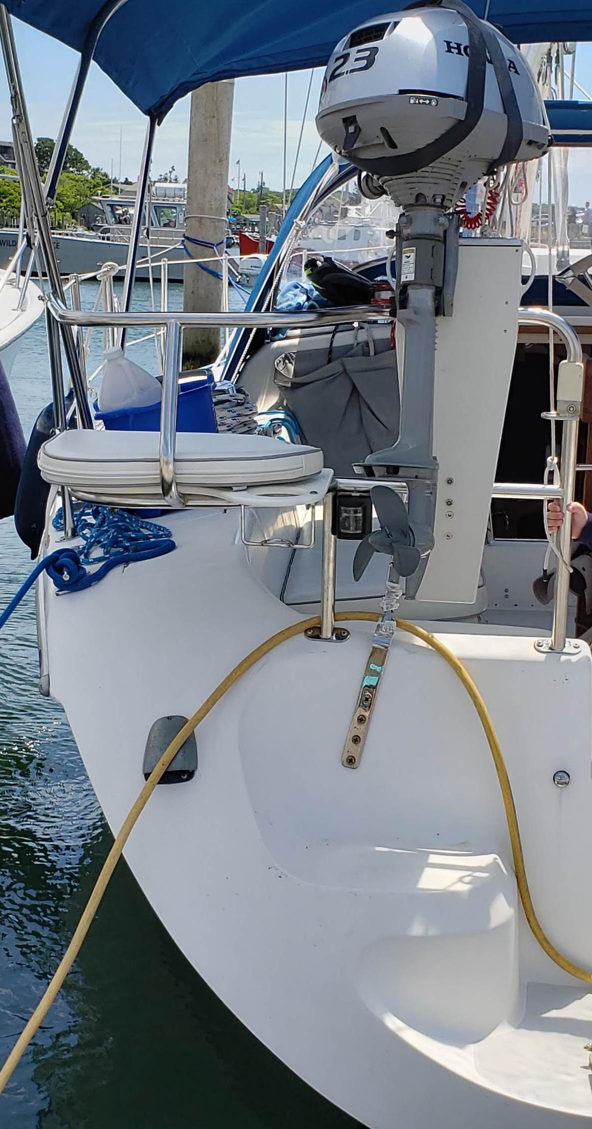

My philosophy is to have the smallest dinghy that I can get away with.  Our boat lives on a mooring, so we use the dinghy every time we sail, but its usually just me dinghying out, then I swing back by the fuel dock to onload the family and all our crap.  So I can get away with an 8' roll-up dinghy and a small Honda 2.3Hp four stroke.  The motor only weighs 29 lbs so its still light enough that I can manage it (so long as I don't blow out a shoulder!).  I also added a motor strap/handle, which is VERY handy.  There are only a few times per season where I am left wishing I had a bigger tender, but those are fleeting and we seem to make do.
At the begginning of last season I added an Edson motor mount to the port side stern rail.  I found it used at a local marine salvage, saved a few bucks that way.  The rail spacing wasnt perfect so I had to drill a couple new holes to accomodate the catalina spacing. Other than that it has been great and I firmly believe has saved the wooden transom on our dinghy (West Marine/Zodiac RU260).  I have enclosed a picture of the motor on the mount.
