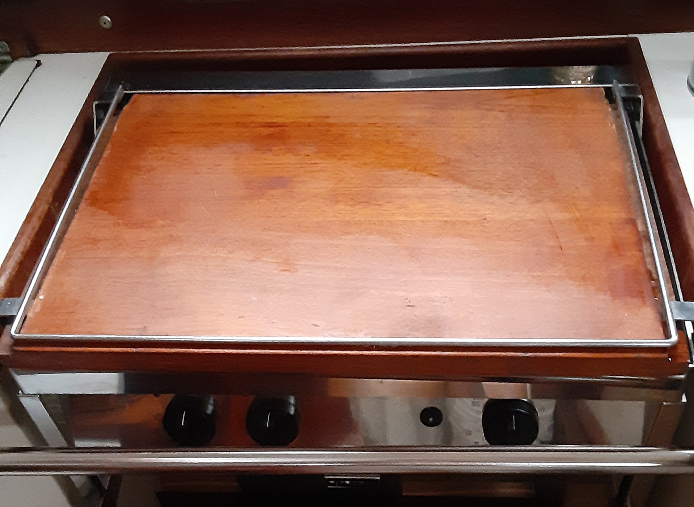

I saw the photo of the Force 10 stove.  I appears to not having a cutting board or more correctly, not able to have a fitted cutting board.  While the C-36 galley has more space than most boats, losing that work surface is a big loss.  What if anything you have done.  I'm not in a hurry to change out a functioning stove, but who knows what the future may bring.

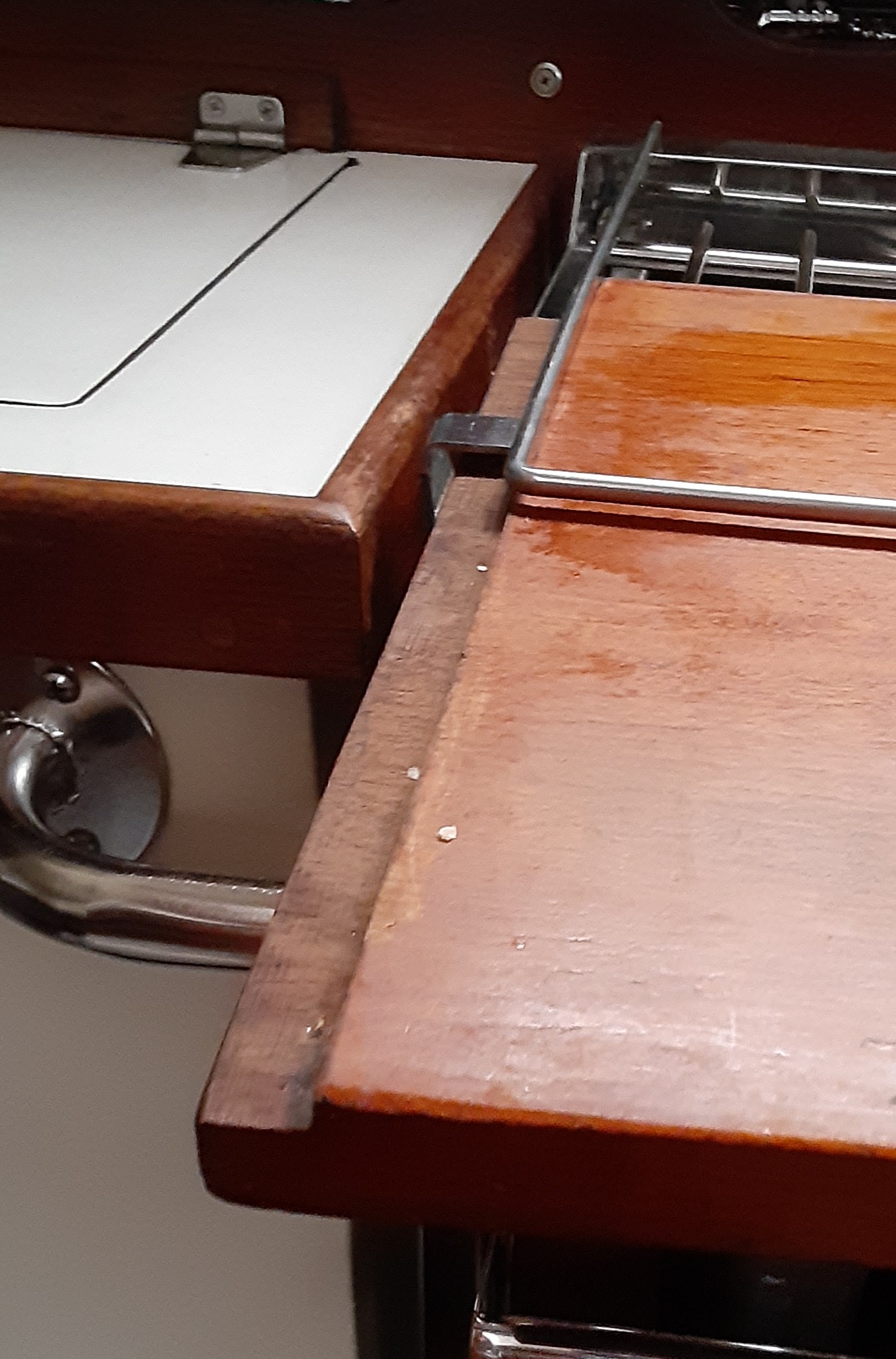

We have a cutting board on ours, which I made out of 3/4" teak boards.  It was actually the cutting board that I had made for our old stove (which fit into the top).   There is a sort of track on the left and right sides of the Force 10; I routed a small recess on the left and right edges of the cutting board and it slides right in and is held firmly in position.   Sorry, no picture handy; will try to  take one next time I'm onboard.

Cutting board photo
