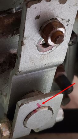

I have had the 1999 C36 MKII now for a couple weeks.  There has been a nagging issue with the transmission:  It doesn't always go in to FWD, it takes a few tries for the fwd gear to engage.  I have ensured that the engine was at dead idle (this engine seems to idle at 750 RPM, too high?).  Thinking that this was a throttle linkage issue, I made an adjustment by popping the cable off it's ball socket, loosened the nut slightly and rotated the control arm on it's axel a few degrees fwd (toward the bow, which set the transmission control lever's neutral position slightly farther aft in it's throw arc.  See the attached pic.  The red arrow points to where I indexed the original position with red tick marks.  Hoping this would engage the transmission in to fwd before the control lever hit the pedestal. It seemed to work initially.  But now it seems I'm back to where I started. It takes a few tries, but eventually goes in to gear.  This is VERY unsettling when maneuvering near the dock or other boats, for obvious reasons.  I saw the service bulletin which talks about making a similar adjustment but mainly deals with adjusting the travel length of the cable itself.   One note: when engaging the transmission by hand (pushing and pulling the control arm when the cable is disconnected from the ball socket) the transmission seems to engage through its full range.  Another oddity:  Once in a while, it seems that the transmission is in fwd gear (the boat moves fwd ever so slightly), except that the prop is only slightly turning despite the increase in RPM.  When it actually goes in gear, you know it, the helm grabs and you can tell it's in gear.  One thing I have yet to try is checking the fluid level.  I will grab the manual and learn how to do this aboard tomorrow.  Before I head down that road, does anyone have any experience with the transmission not wanting to go in to fwd gear? Thanks again for the guidance!

If I understand, you can fully engage FWD and REV by hand (control cable disconnected)? You should see a very positive engagement when below - you can also hear a bit of a clunk (something I never hear when the engine is closed up). If yes to that working, you have a cable issue. The manual for the engine covers the throw range required.
If you are not getting positive engagement in the above, you now need to look at the tranny. Start with the fluid, over or under filling can be a problem. I measure the height with the dip stick fully engaged. The manal does not specify to dip it, or thread it and then remove to read. All other dip sticks I've used on anything, you fully seat the dipper the get a reading. The transmission holds a scant amount of ATF. I use synthetic fluid, as the tranny runs hot. Use an oil vacuum pump (west marine and others sell them) to change the fluid.

Hey Greg, thanks for the advice. I just checked the fluid, seems good and bright red, looks fresh to me but I'm going to check with the PO. I'm hearing and feeling a definitive pop, when engaging into and out of fwd and rev when doing it by hand (moving the throw arm by hand). So it lends itself to a cable issue. The PO mentioned that the engine needs to be at dead idle to engage, but that sounds like good practice rather than a mechanical reason? Still tinkering here, I'll let you know what I find.

My next step is to investigate the linkage connection at the helm. Edson provides pretty good directions for removing the compass. Although the fact that I am hearing a definitive click, in and out of gear, with the engine off and looking in at the tranny from the aft berth, leads me to believe there is something going on when the engine is running, only when the gear box is under pressure.
