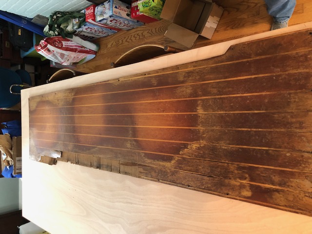

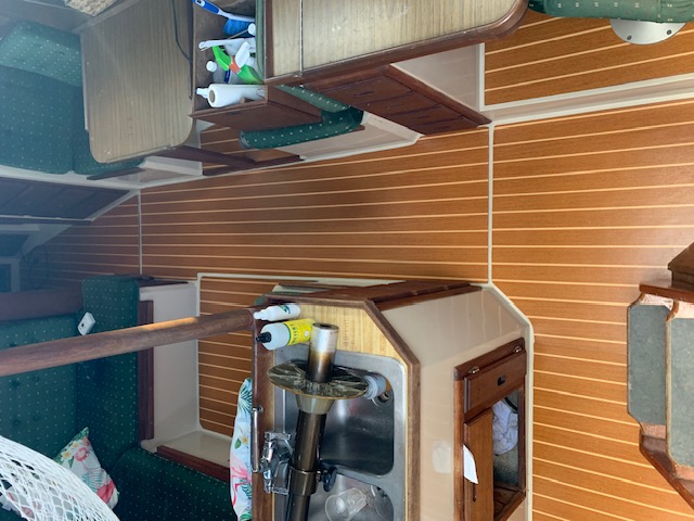

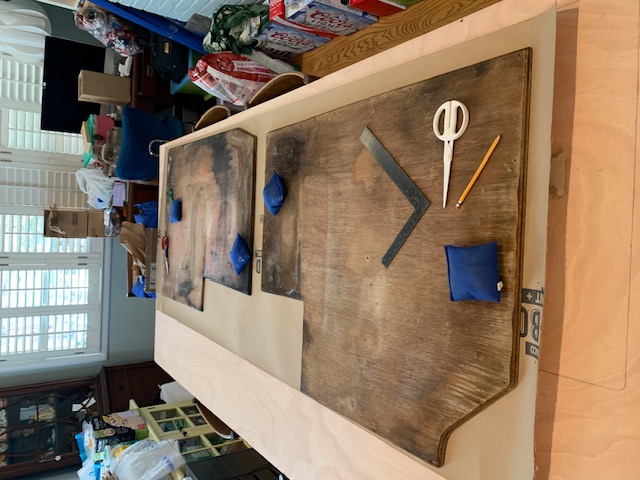

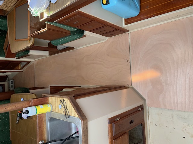

Just adding to the old thread on replacing the H&T sole with lonseal.  Chuck's instructions are fabulous--I just did the project and will provide photos once I uncover the boat.   He was a wealth of offline guidance and support.
Two notes to add to the conversation--first, I used my existing boards as templates before noticing that the originals were not perfectly sized nor "straight edges" cut strait. I reproduced the first board "perfectly" and then noticed there were gaps.  Easy fix and in one case I built out with structural epoxy.  One important new addition to the conversation--Lonseal confirms that you can use west system epoxy with 406 colloidal filler mixed to a mayonnaise like consistency.  This allowed me to mix the epoxy in "right size" batches that gave me the time to carefully line up the pieces.  Although not in the instructions, I whetted the plywood with unthickened epoxy (I used the slow hardener) and then troweled thickened epoxy, rolled out the Lonseal and used a 100 pound roller.   This year's winter has gone from 45 degrees to -10 degrees and no issues with the strength of the bond.

Wow!  Looks great
