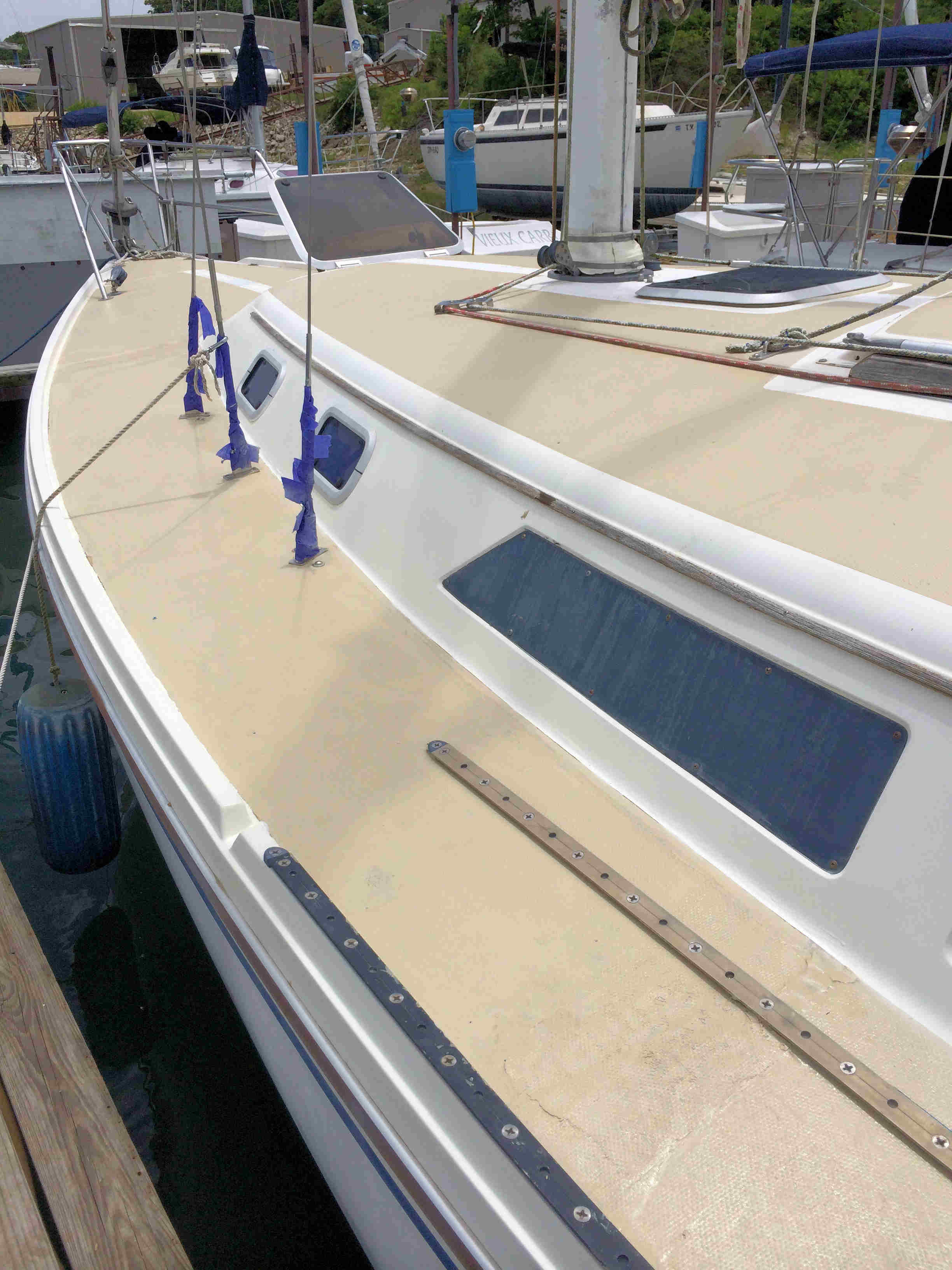

Fair enough Tom.  When purchasing a used C36 it is a key area to check. I would include the bulkhead areas directly beneath the primary chain plates since they may visually show a lack of maintenance.My starboard side deck did not show the same problem and is as sound as can be.  Plus if you find a boat with this issue it is fixable by a handy owner who has time, some basic skills (these can be learned) and not a lot of money ($110 for marine ply, $300 in glass and resin, $200 gelcoat).- I've attached the initial post repair picture (although I still have to go back and do some non-skid pattern mold touch up).
Catalina has changed the construction technique and now keeps the coring several inches away from the chain plates and uses a cover with more gripping surface. When I recored my side deck I cut the core back an inch from the chain plate and built up the area with a flexible epoxy/glass mix.
