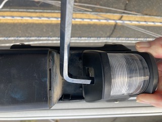

Update... finally!!

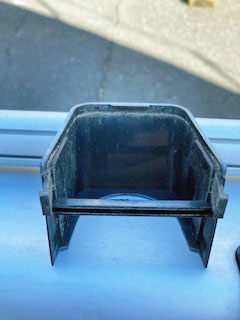

Got the lens off... here are the details... 1st you have to remove the cover/shield between the top steaming light and the fore deck light.  There are indentations that you are supposed to squeeze on both sides to release the cover but, as you can se from the picture, there is a plastic "rod" going from one side to the other right about where you'd expect to squeeze. You have to get really close to the mast for the pressure points to release the cover.
Once off, there is a button on the bottom of the steaming light that needs to be pushed upto release the light lens. The lens should release from the bottom and swing up. However, I found, unless you have very short, stubby fingers, you can't get enough pressure parallel to the mast to release the catch. I tried pushing with a screw driver but that puts pressure on the button on an angle.
My solution was to use a fairly thick allen wrench (see 2nd picture). I have a set in which the larger sizes have a fairly long extension which allows holding onto it while pushing up. This popped the lens off.
Be forewarned, the lens seemed to pop off, not swing out. If you are doing this with the mast up and aren't ready for it, your lens might go swimming with the fishes.
Now to get the new bulbs and see how easy it is to put it all back together.
