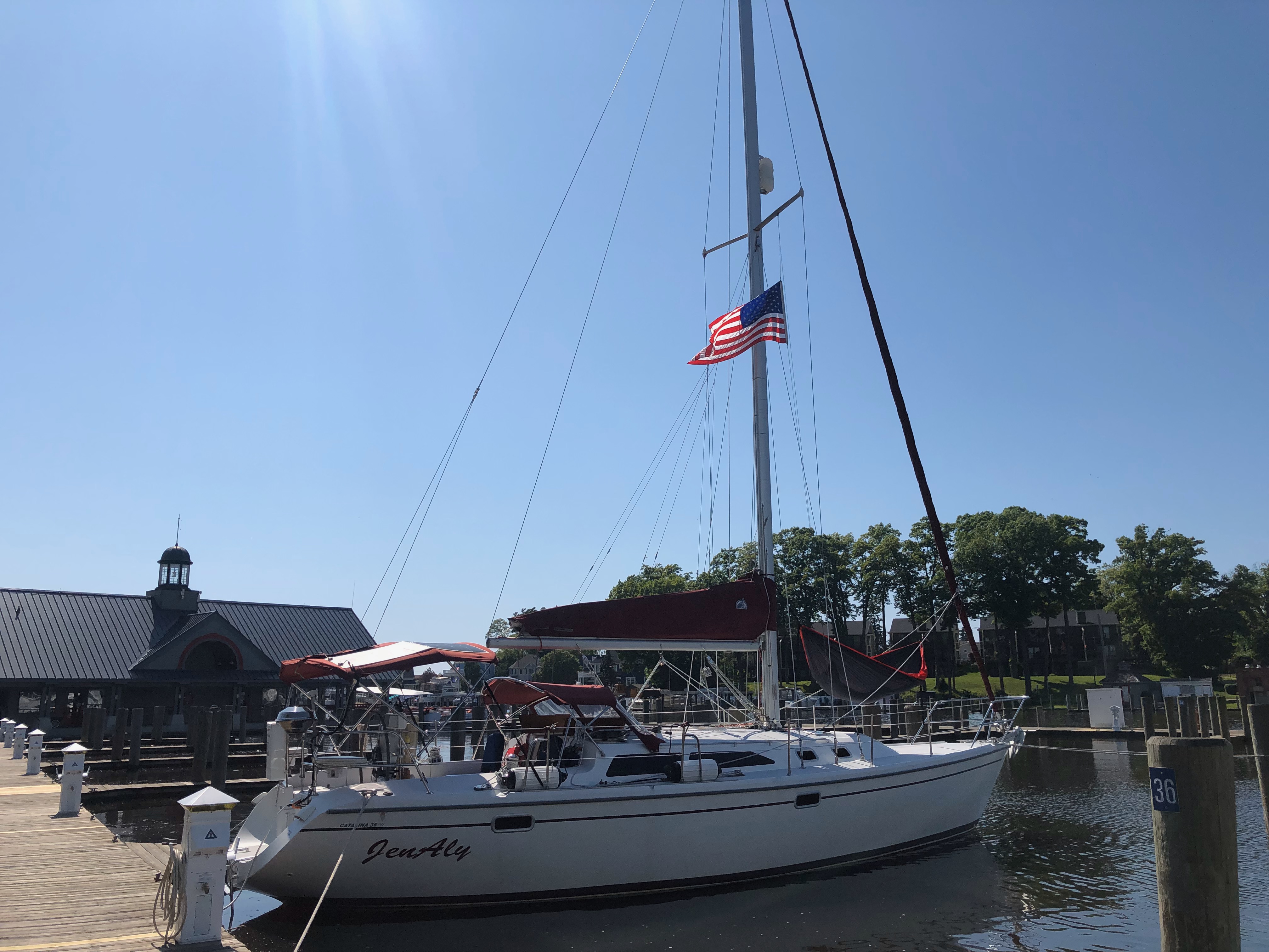

I have a picture of the boat not specifically the panels. In the picture, if you look on top of the bimini, you can see one panel. The other is attached the same way on the other side of the backstay.

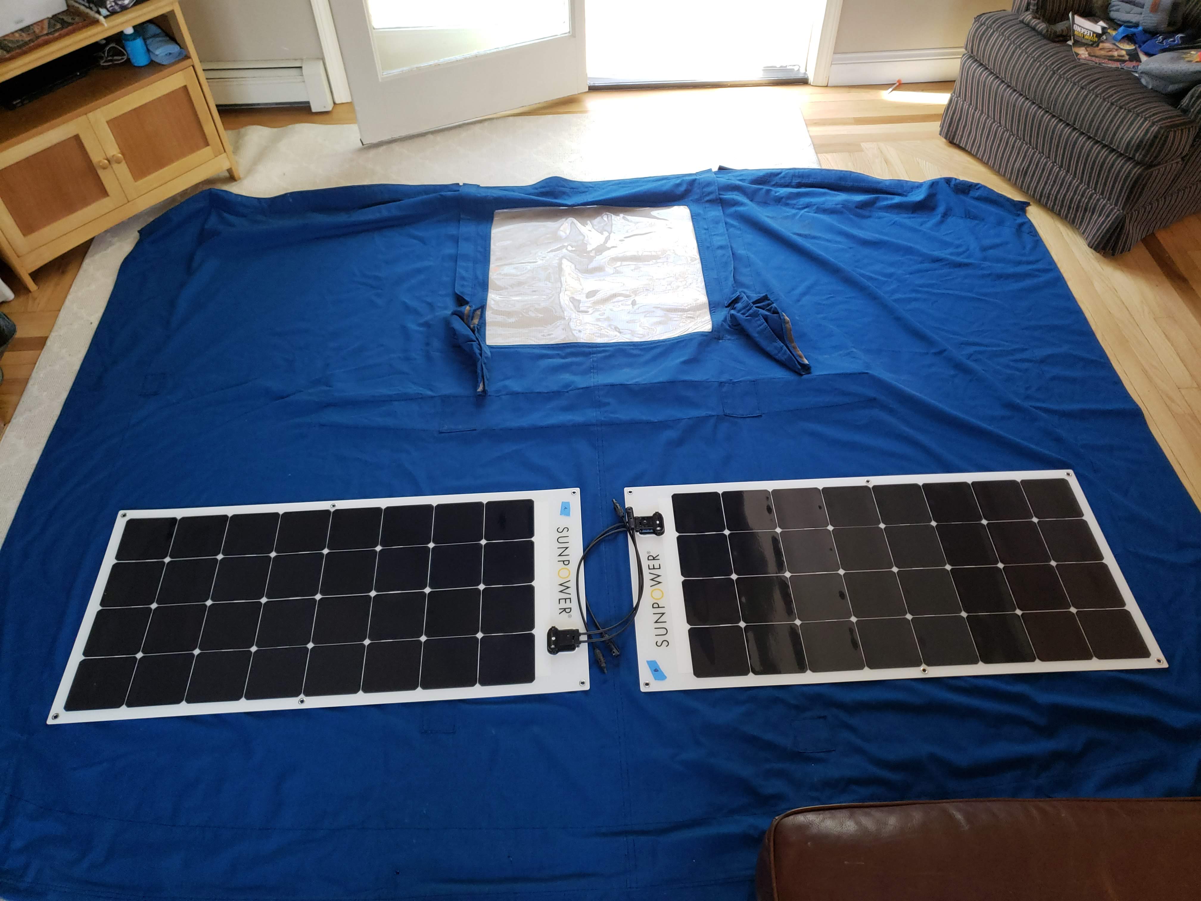

UPDATE:  Ended up going with the zipper attachment for the solar panels, glad I did.  Thanks for the advice once again Chachere.  I laid out the design for the apolstery lady, in her shop, and she came up with some great ideas.  First, and most importantly, she sewed in a reinforcement panel, of the same color sunbrella that I already had.  She even matched up existing stitching so as not to add additional stitch lines.  Then she sewed on half a zipper to each long edge of each panel, and the other half to a lapel sewed to the bimini.  Additionally, she sewed a lapel running the entire length of each long edge with velcro on the underside and velcor on the panel, just inboard of the zipper.  This made a cover for the zippers.  The wires emanate from holes in the center where they enter a velcro "tunnel" that angles back to the stbd back-stay, down and through the transom, etc.
This was tested this week as we are preparing for a high winds associated with TS Isiahas.  My goal was always to have the ability to take down the solar and fold up the bimini to ride out a storm.  Seemed to work as planned.  My only regret is the flexible panels are a bit "too" flexible, so there is some sag.  I may add fore-aft battens under them to promote an upward arch to the panels.
