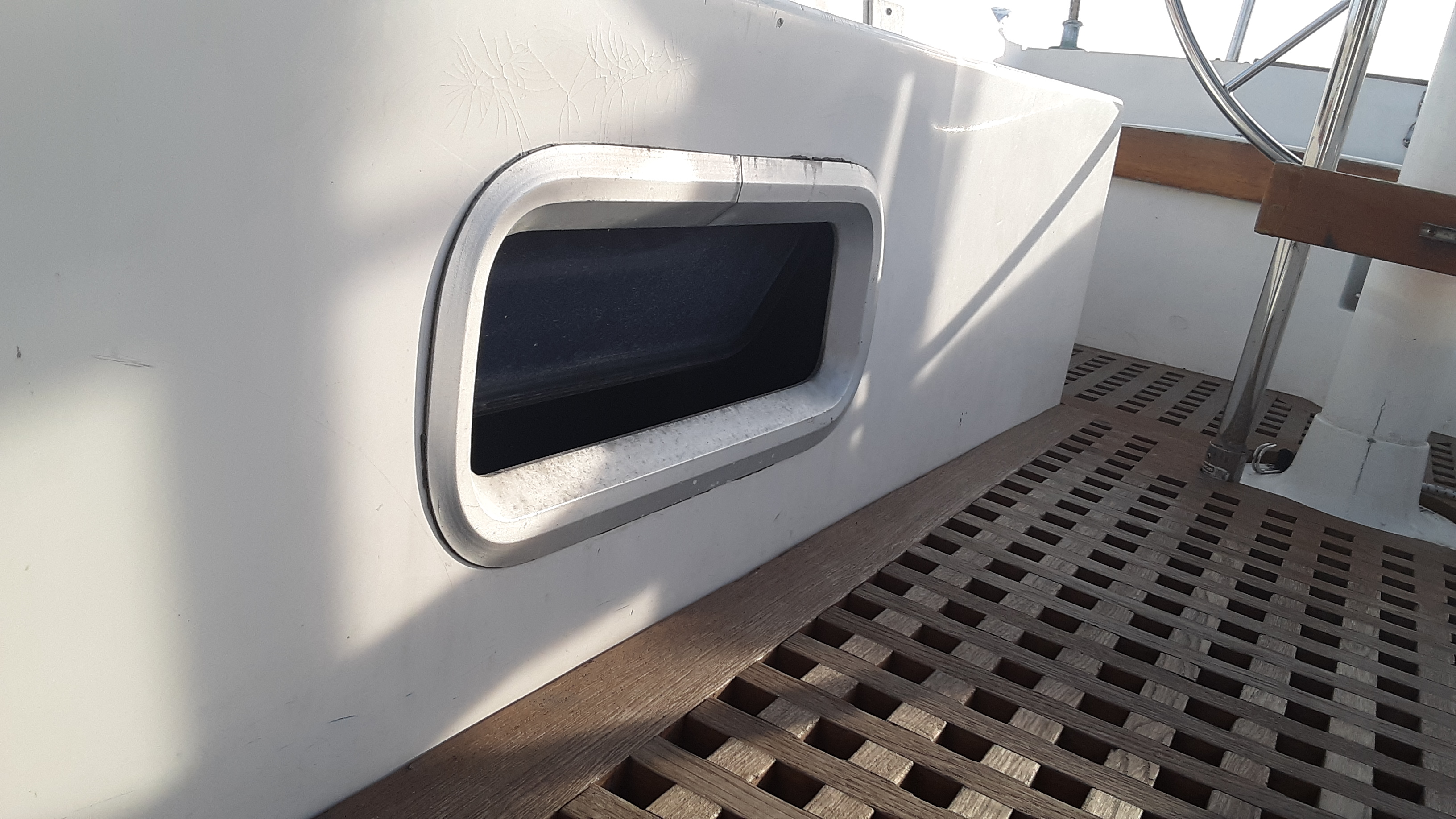

After I replaced all the portlights in our '85 C36 (see www.catalina36.org/comment/58853#comment-58853 ), I repurposed one of the two opening portlights (the most forward of them, located in the head and opposite it) to replace the fixed portlight in the cockpit that John refers to.
Its almost the same size, and with a little bit of cutting to very slightly enlarge the raw opening I was able to install it.
Nice enhancement, adds some ventilation to the aft cabin.
I've got one left, if anyone wants it, its yours for the asking (send me a PM or email to discuss)
