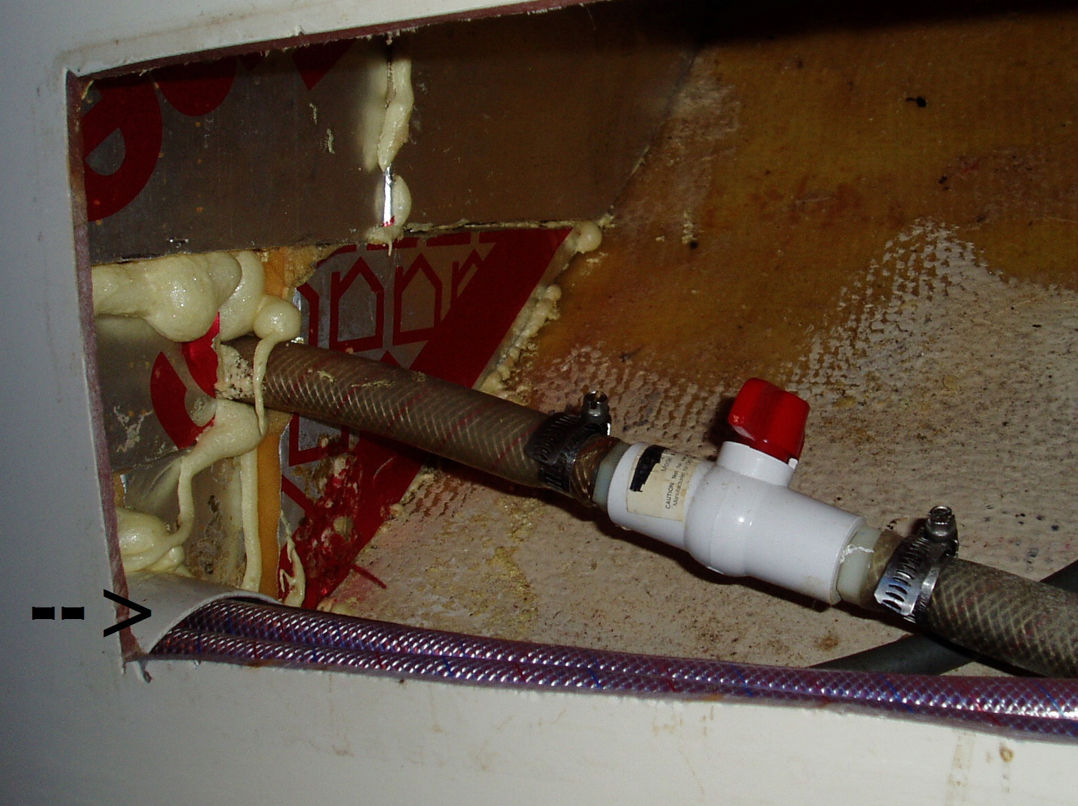

jakez's picture
jakez
Joined: 7/21/14
Posts: 25
I had the same problem.  My fridge would fill up on a starboard tack with the sink drain open.  I added a stop cock on the T connector where the fridge line goes into the sink drain line just above the thru hull.  I keep that stop cock closed pretty much all the time and it has solved the problem.  The only time I've opened it is when something spilled in the fridge and I needed to rinse it out.  Pic attached.
Jake Z
five o'clock somewhere
2000 Catalina 36 MKII
Hull #1836
