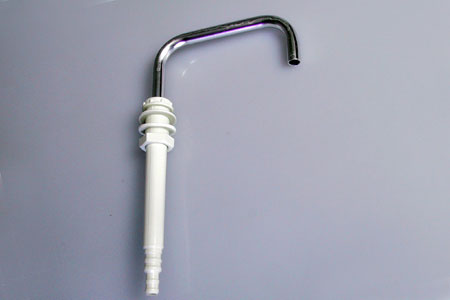

On our boat the line from the refer foot pump goes to a small spout mounted just above the sink. Since we usually load up the refer with block ice when cruising, we end up with a fair supply of melt water that we sometimes use for the first run of dishwashing (followed, of course, by a final freshwater rinse from the onboard tank supply). Having the refer water exit above the sink means there is never sea water backing up into the refer.
I thought this was a standard installation, but reading this thread I now realize that a PO must have customized this.
(I had thought it was factory, but from this discussion I realize its not). It looks like the spout that's on our boat is the one available at Catalina Direct (photo attached as well).
