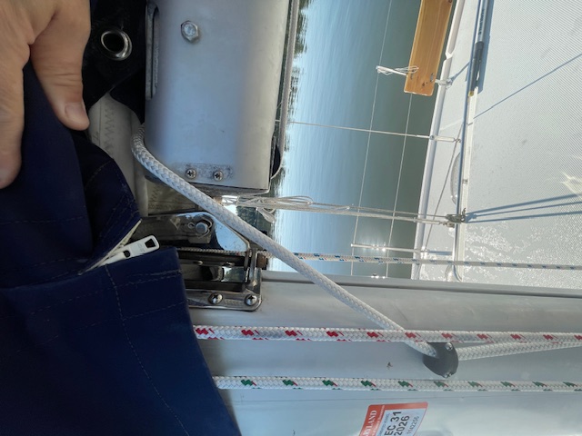

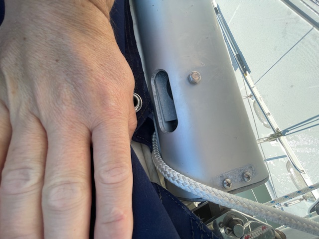

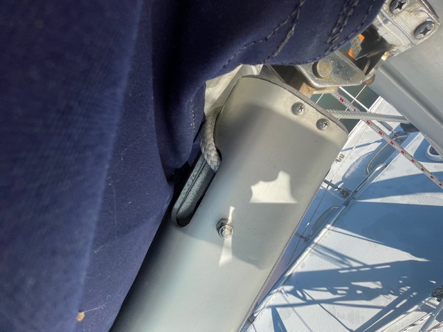

Hi folks, A few months into owning Escapade and still sorting some “where’s and what’s” Question about reefing line setup (I did search the forum but no threads that really cleared it up for me): There are no “horns” typical to a slab reef setup. I saw mention on another thread of a separate line to use to secure the luff cringe to boom. Another thread mentioned a single line reef setup (which I’m inclined to believe is what mine is meant to be) my current setup (how I got the boat in the spring): reef line from port cockpit forward through deck organizer to a block at base of mast, then up through a fairlead. From there it’s an awkward angle to the starboard side of boom and into an opening there to travel aft (see the pics— I can’t seem to rotate them so hopefully it makes sense). It’s telling that, where the line enters on that starboard side of the boom, it’s not riding the sheave which supports my “this isn’t correct” conclusion. I “think” that I’m supposed to instead run from the fairlead on port side, up through luff cringe, then down to that opening in from of starboard boom and ride under the sheave to then travel back through the boom. Is that correct? If that’s correct, then I guess I need to pull the line back through the front of boom (with a guide line trailing behind) to rerun stuff. And then at end of season when sail needs to come off , I just pull the line forward leaving the guideline secured in there for yanking back through in the spring? Curious if that’s how folks do this or if I’m missing the obvious here Thanks all, Brad

You are right that it is not installed correctly.
I would pull the line back out of the cockpit and out of the fairlead and move the line to the starboard. Raise the sail until the first reef cringle is just above the boom.
insert the end of the line you just pulled back into the cringle from the starboard side and let it drop down to the block at the base of the mast and back to the cockpit as it was before.
When you like to remove the sail undo the line back to the boom from the cockpit the same way.
On the aft end of the boom, this line should exit through a sheeve on the starboard side of the boom, then go up to the first reef cringle, then back down to the boom through a small cringle at the foot of the sail and wrap around the boom. When you pull on the reef line from the cockpit the sail should drop down.

Haro is correct.  I have this arrangement on board Stray.  When you crank down on the reef line (port side cockpit) it pulls both the new tack and the new clew down to the boom.  Easy peasy :)

Aaahhhh.  That makes sense.
Many thanks
