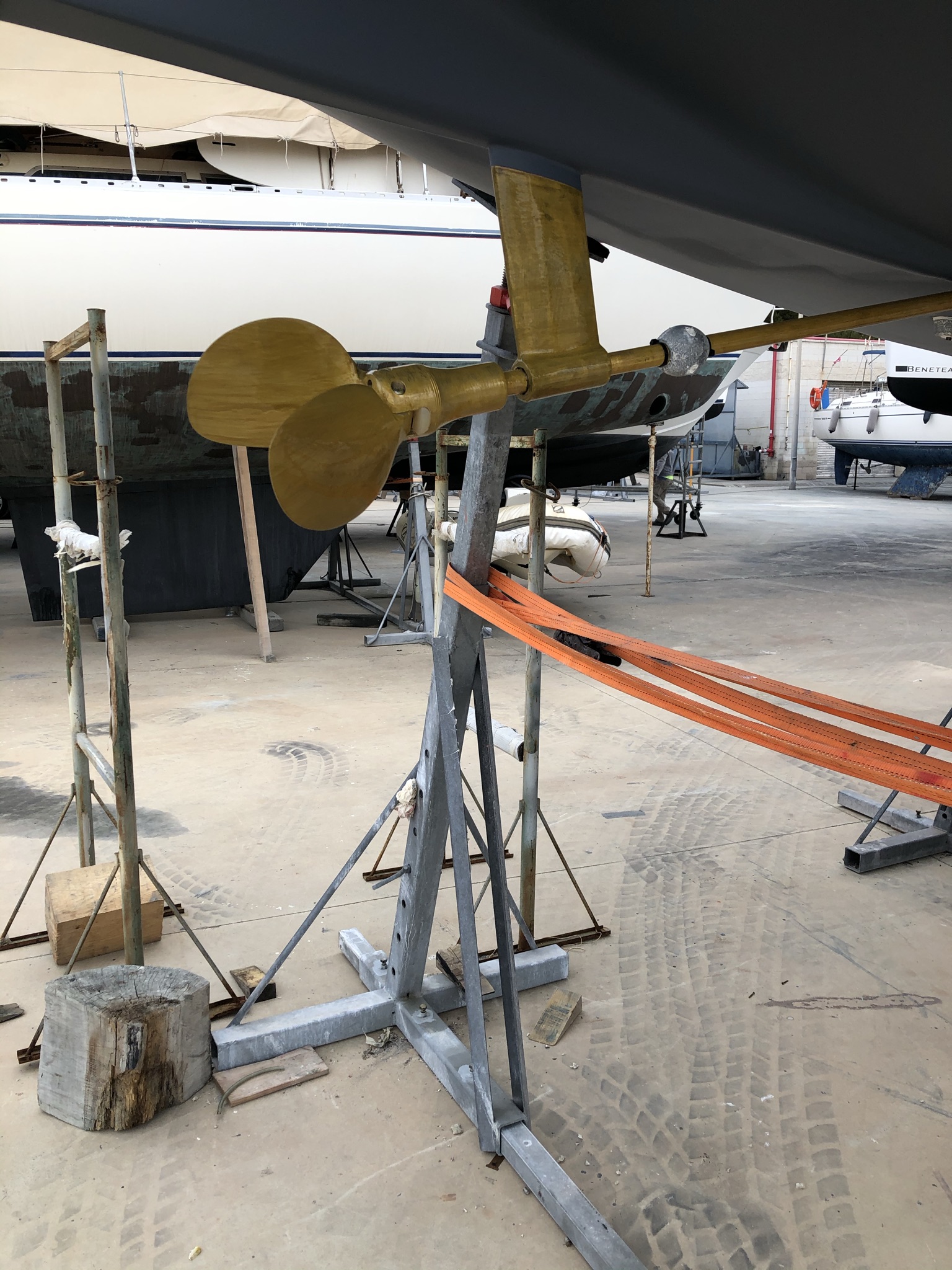

We first installed a 16*11 Flexofold two blades, engine clearly over pitched.
Flexofold exchange the blades to 15*10, much better as the boat reaches the maximum rpm (3.200) no more no less.
must probably, a 15*10,5, that will reduces rpm by about 100 will be ideal.
