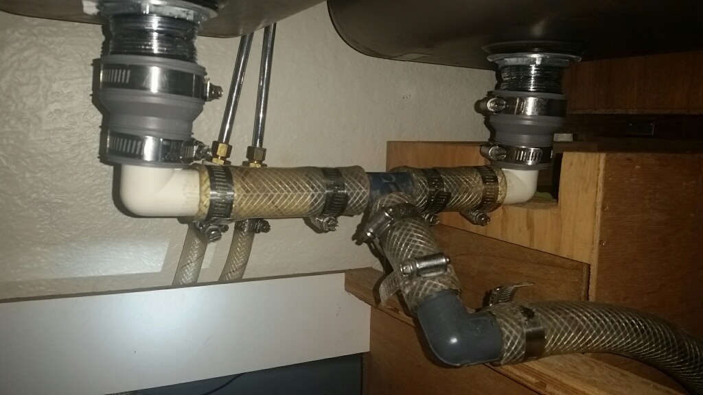

Would anybody be able to take a photograph of their under drain plumbing in the Galley for me? Someone redid mine this week and now I can't put the large door panel back on. I'd like to show them how it was, so they know how to make it right. My boat is a 1998 Catalina 36 Mark 2, any help would be appreciated, thanks very much if you are able to send a pic

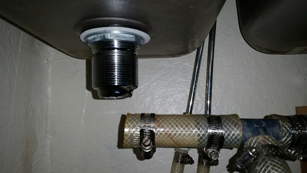

Rich, I had to cut the new drain pipes down very short to allow the top flip down drawer to close after assembly.  See photos below. Also had to jerry-rig the connections with the grey adapters and a white plumbing 90 degree that fit just right.  No leaks since the installation 5 years ago, however.
