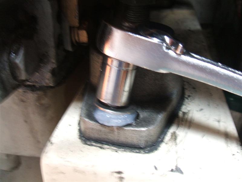

So I was servicing my engine yesterday when I noticed a bolt that held one of the motor mounts was loose. I went to tighten it, and imagine my surprise when the bolt head just fell off! I of course checked the other bolt, and it too fell off! Now I have a motor mount that is not attached to the stringer. It's not the sheared bolts that bother me however...
I noticed one of the bolt heads had been epoxied back in place!!!!! That means the previous owner knew of the problem, and devised a half-assed fix to last long enough to sell the boat.
Up until now, I had always just questioned his sanity with some of the silly maintenance decisions I have had to rectify over the past 2 years; but this is something else entirely. He has put our safety in jeopardy with this malicious cover up. Not to mention I now need to figure out how to get new bolts back in there.
My plan is to somehow drill out slightly larger holes and remount with larger bolts. Thankfully I discovered this at the dock, but this comes at a pretty bad time as I am supposed to do the intercoastal trip to Florida next month.

I had the lag bolts back out of the holes on our engine mounts. Instead of epoxy I used silicone sealant to keep them in. Most of the bolt load is in shear, so keeping the bolts in helps, which is why he did it. Many say the torque of the engine requires the bolts to be used to hold one side of the engine down -- there's some truth to this conjecture, although I believe the weight of the engine is sufficient. The epoxy he did didn't require any drilling on his part, although I understand what it is you describe that you need to do. I agree, that's what I would do or do as suggested above.
You have a month til your cruise. If it's only two engine mounts and they are the ones you can get to, this is a 2 hour job, at the worst a whole day. Even if all four mounts and all eight lag bolts, once you do the first two, you'll get good at it and the rest will go quickly. :) Think of this as advantage and a challenge and an opportunity in a time of crisis to grow. Many folks have lag bolts backing out and need to reinstall them. Why? Because the wood in the stringer is all used up and they need thicker bolts and pretty much the same drilling effort.

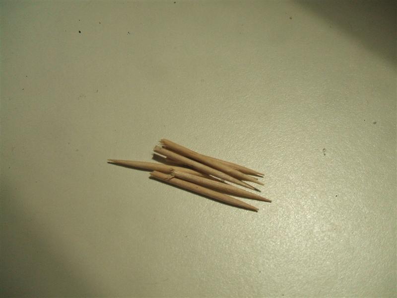

Steve, I agree. The point of my post was not to detail the way I prepared the holes, but since you asked... I cut up and installed a bunch of toothpicks and stuck 'em down the hole and sealed them a half hour or so before I put the lag bolts back in. That was two years ago, engine hasn't moved. Well, at least it's still there when I motor, start, stop, reverse and chug along! :D
The devil's in the details for using an epoxy fix, because that means you HAVE to move the motor mounts to drill, epoxy and re-drill out, which I was not prepared to do. The toothpick idea is an old carpenter's trick taken to, I must admit, the extreme, but it works. I've have had this comment from everyone who hears about it, not unexpected. Only needed on two different bolts on two different mounts, too.
Well geeze Stu, you did not mention you used toothpicks as well.
In fact that may be a very effective repair and one I have used in several situations. Assuming that the wood is still sound in the engine mount log, toothpicks will restrore much of the grip of the lag bolt and silicone will seal out moisture. Though redrilling the bolt hole after filling with epoxy may not be required. On my last boat I had this issue, on that installation I drilled out the hole two sizes up, until I came up with fresh dry wood. I then augreedr out the hole by moving the drill around in the hole to make the bottom larger than the top, filled the hole up about half way with epoxy, coated the bolt with wax so the epoxy would not stick to it and ran it back in the hole, let the epoxy set then removed the bolt and ran it in and torqued it down, it held solidly. If the hole is just stripped and not rotten this can be done with out drilling and augering the hole and just using the epoxy and a mold release on the bolt. If you restore the grip you are in business and yes your toothpicks may well do this just as well, your original discription indicated you may have just used silicone, a miracle product as adhesive in some applications and a good sealant but, I would not trust it to hold my engine in place by itself.
Did you use round toothpicks or flat ones? I understand that the mint flovored ones also deter termites.

I disagree with you on this one. You didn't blame your PO because he didn't attempt to conceal the fact that the bracket wasn't installed. The epoxy was used to quite literally glue the head back in to place. There is no purchase on the stringer with this "repair".
Had I glued the bolt head back on and found it some time later loose in the mount perhaps I would agree with you, but I didn't so we'll have to agree to disagree.
The problem with using extraction bits it the limited amount of room I have to work with. The good new is that it is only on one mount, so I'm just going to run with it. I'll pay to have them swapped out when it is on the hard for the next couple months.

[QUOTE=Steve Frost;5462]Well geeze Stu, you did not mention you used toothpicks as well.
Did you use round toothpicks or flat ones? I understand that the mint flovored ones also deter termites.[/QUOTE]
Round, plain, no colors, no flavoring! :) I just knew I'd elicit the correct methodology with my toothpicks story. BTW, here they are:
