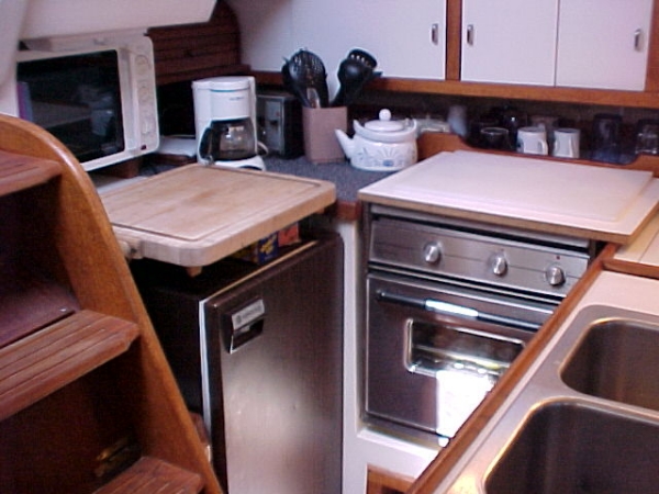

I'm not too sure about under the Nav station since my boat is a MK I, but here's a picture I found somewhere of a nice sized frig next to the companionway. Seems to fit pretty well. Just an idea.
[ATTACH]122[/ATTACH] Click to enlarge

Wow, I would never have though sticking a fridge there would be quite so clean looking. I wonder if its dual power 120/12V? I also wonder if it would more efficient or less efficent that the standard fridge.

The photo'ed installation is superb.
Most "production" fridges have MUCH better insulation than our "boxes" but are much smaller in capacity.

I am planning on measuring available small refrigerators to fit in this same location when I get to my boat tomorrow. I like the placement of it there. I own a 2001 MkII. Seems like they make refrigerators small enough to slide right in there after some carpentry work to make it fit.
