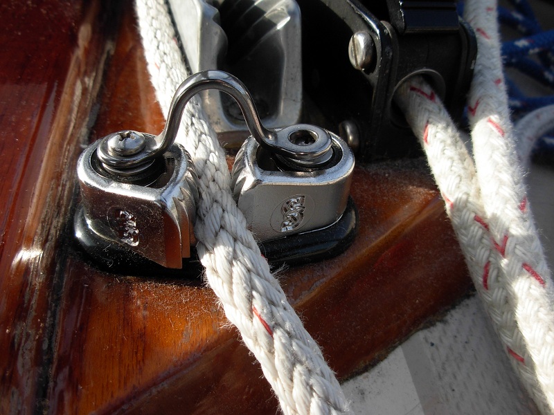

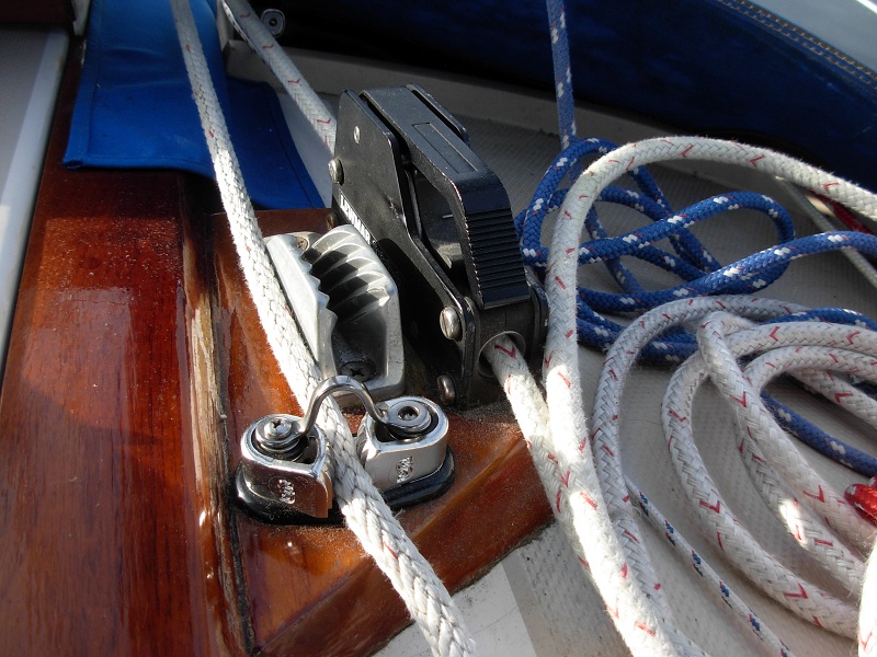

Have included some pictures of an option for securing the mainsheet behind and to the side of Catalina's miserable POS clam (or jam?) cleat.
Since I almost universally singlehand, leaving the helm to handle the mainsheet, especially following the boom during a jibe, has always been a PITA. A cam cleat with overhead fairlead allows me to take the mainsheet to the helm and "pop" it out of the cam cleat with an upward tug. Resetting the main in the cleat after a jibe does require I go forward a bit to get enough downward pull on the line into the cleat's jaws, but without having to press the line down with my fingers into the old clam cleat. I might try elevating the cam cleat to make this easier, but for now it works well enough for me.
In light air I use the cam cleat, but when the wind builds the 500 lb working load rating and #10 machine screw mounting make me feel better with the sheet led to the winch. I generally don't jibe (intentionally) in those conditions anyway. Getting the cam cleat to let go, after the mainsheet has been tensioned, can be a chore, but comes out of the jaws easily when led to the winch.
Originally I had the fairlead's mounting holes through both screws, but shifting it over to the winch caused me to either reroute the sheet in its entirety, or get enough slack in it to double up and then go to the winch. Hardly an elegant solution. I removed one mounting screw from the fairlead and torqued the nut just enough so the fairlead can rotate around on top of the cleat. It remains snug enough such that the upward tug releases the line without the fairlead being bent out of shape. When it's time to go to the winch, the fairlead swings off the top of the cleat. Otherwise the unused mounting hole sits on top of the cleat's Phillips head screw as in a detent.
Hopefully the pictures will clear up the confusion generated by my poor technical writing skills.
Cam cleat: Schaefer's 70-39 (5/8" max line size) - Defender #603117 $71 comes with its own "on top" fairlead. West Marine does not carry this item, so I ordered a Schaefer 70-38, removed its integral fairlead, and added a Ronstan RF1055 eye strap for $3.79 to take advantage of the price match and no shipping charges. The Defender # is 615141 for the eye strap.
Am not advocating this for any application other than light air, but it has made life easier for me aboard. Hope this is helpful.
