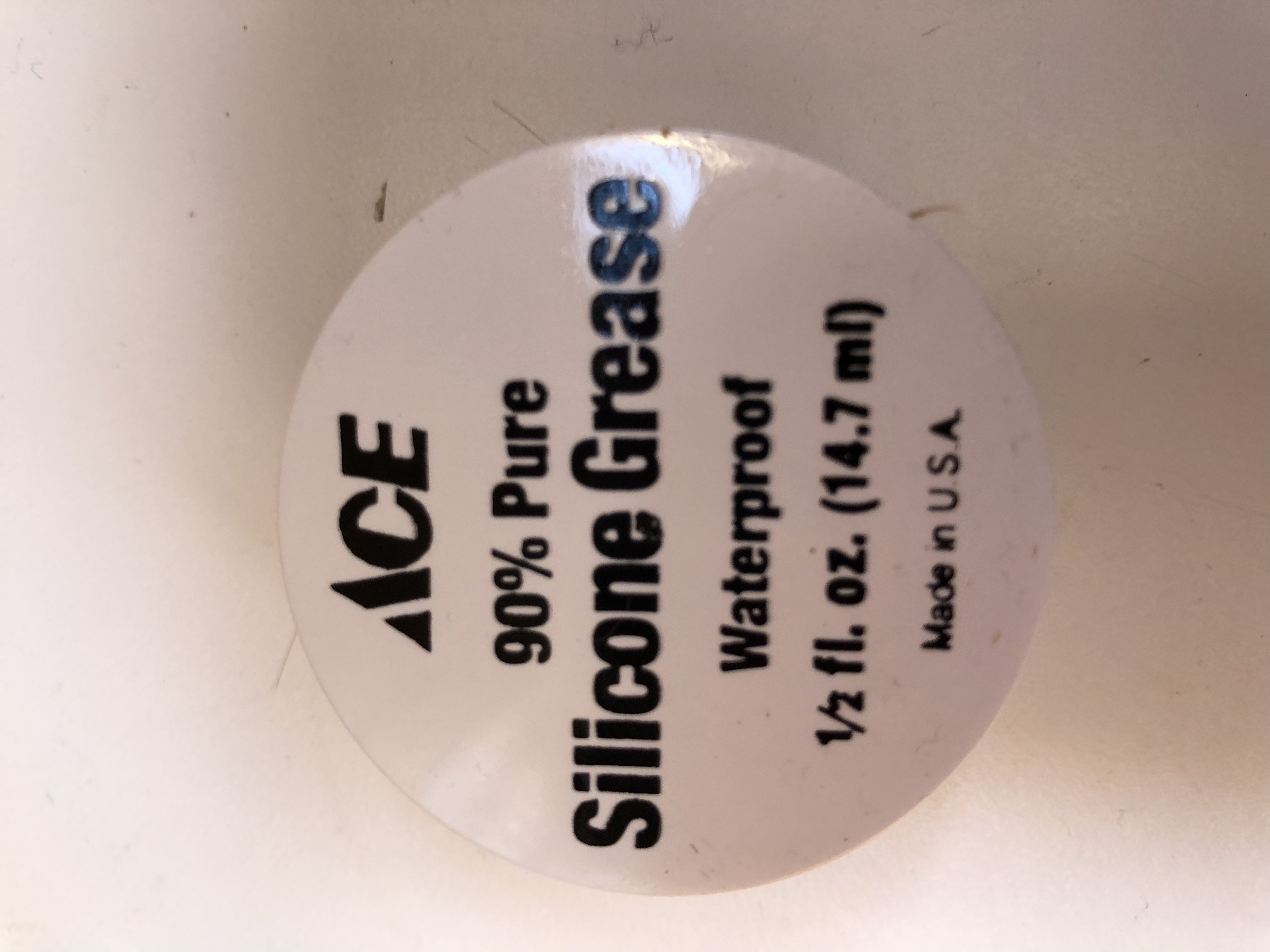

Pump on Jabsco toilet occasionally gets stiff.  I then take out the six screws on top of the plunger assembly, wipe the cylinder wall and rim of plunger gasket with a lubricant.  I’ve tried various readily on hand lubricants (olive oil, etc) and this is good for a few days and gets stiff again.
What lubricant do you think might be impervious to the corrosive effects of piss water?

Silicone plumbers grease at Ace True value works so far.  $5 for small jar.  Applied with old tooth brush.
