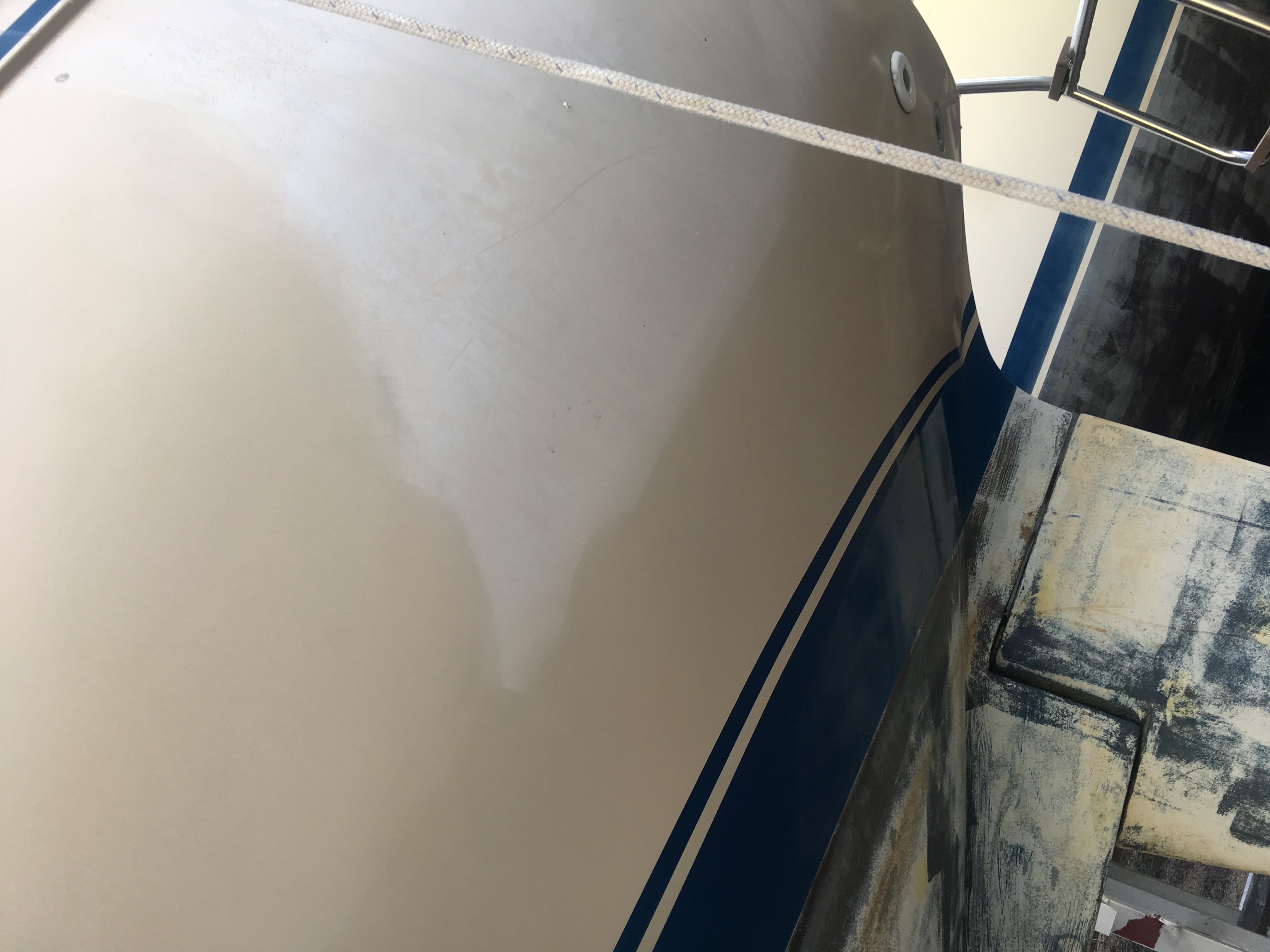

4) started sanding, cutting, buffing, waxing the hull (big job).

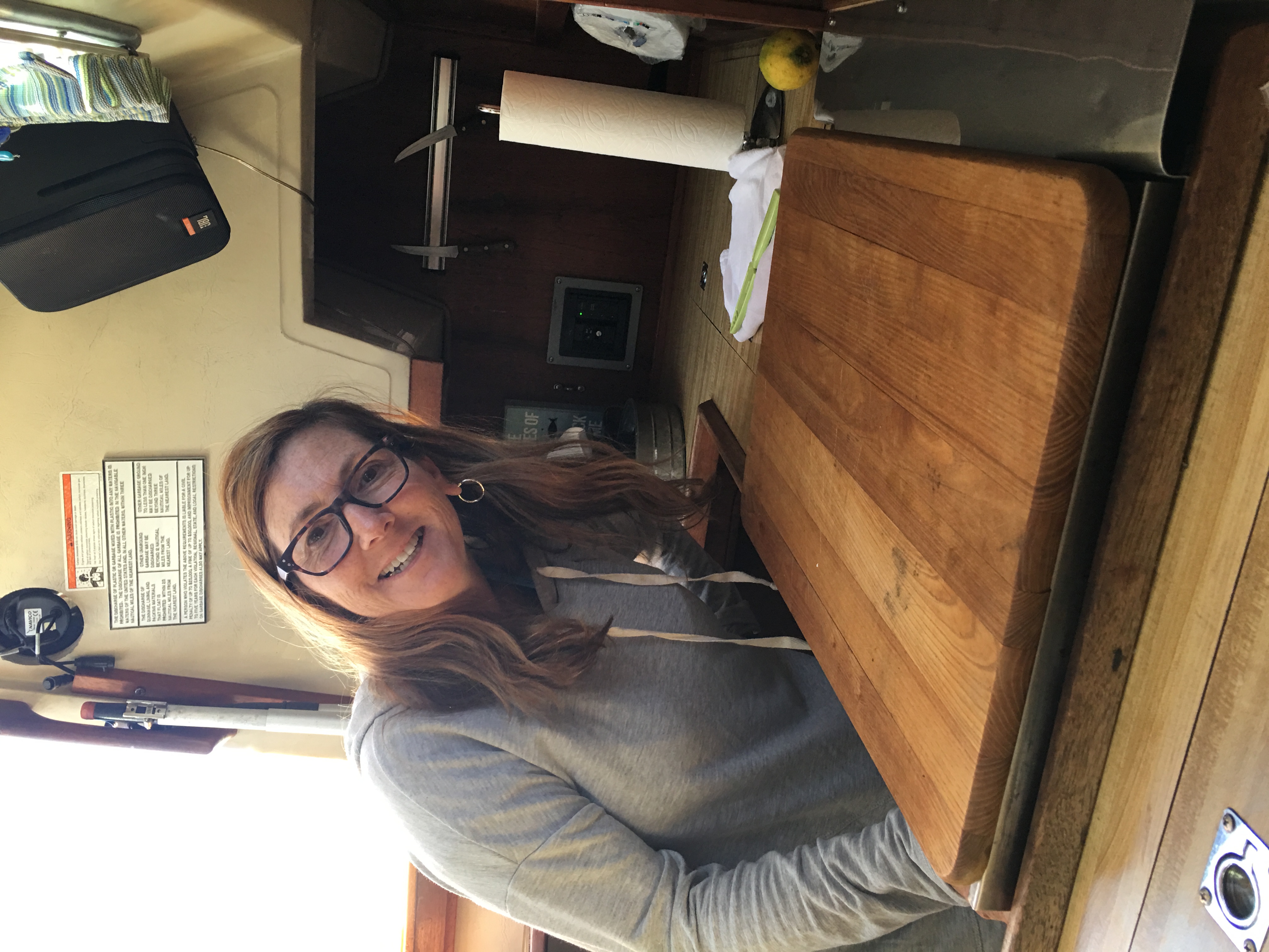

5) best of all fabricate and install a simple stainless & maple "lime" catcher behind the stove.
On our last trip up the the San Juans - The admiral informed me the limes went missing, she check the frig twice - but no limes for the gin & tonics.  While cleaning up back in Everett, we found the offending limes were found behind the stove.  This lime catcher fits springs against the outside of the stove on the either side - then a chunk of maple from the shop pushes against the cabinet behind the stove.  It pulls right out if we need the stove to gimbal, but when installed  prevents chopped items and things unloaded from the frig from getting lost behind the stove.  The area that acts as the "spring" allows the cutting board to fit normally.  Best of all all the admiral   is thrilled - you can see it in the photo's below (you can see one of the offending limes on the counter).

Depending how oxidized it is, you may have to start with 1000 grit wer&dry and move up to 1200,1400 &1600 to remove all the oxidation.
