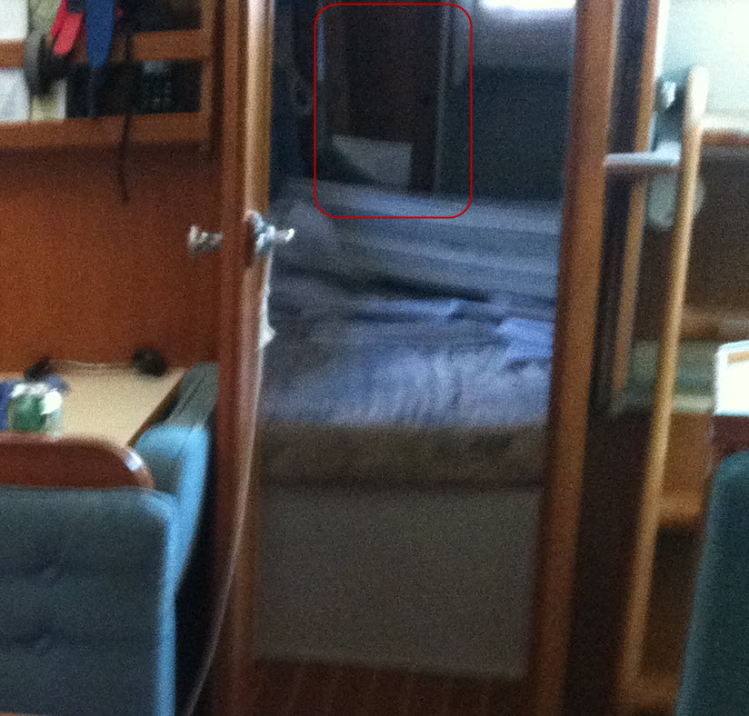

Our C36 1993 has a freedom 20 mounted in the aft locker of the aft cabin on stbd. They installed a vent with hose to the cooling intake on the freedom 20 to pull air from aft cabin. See picture.
