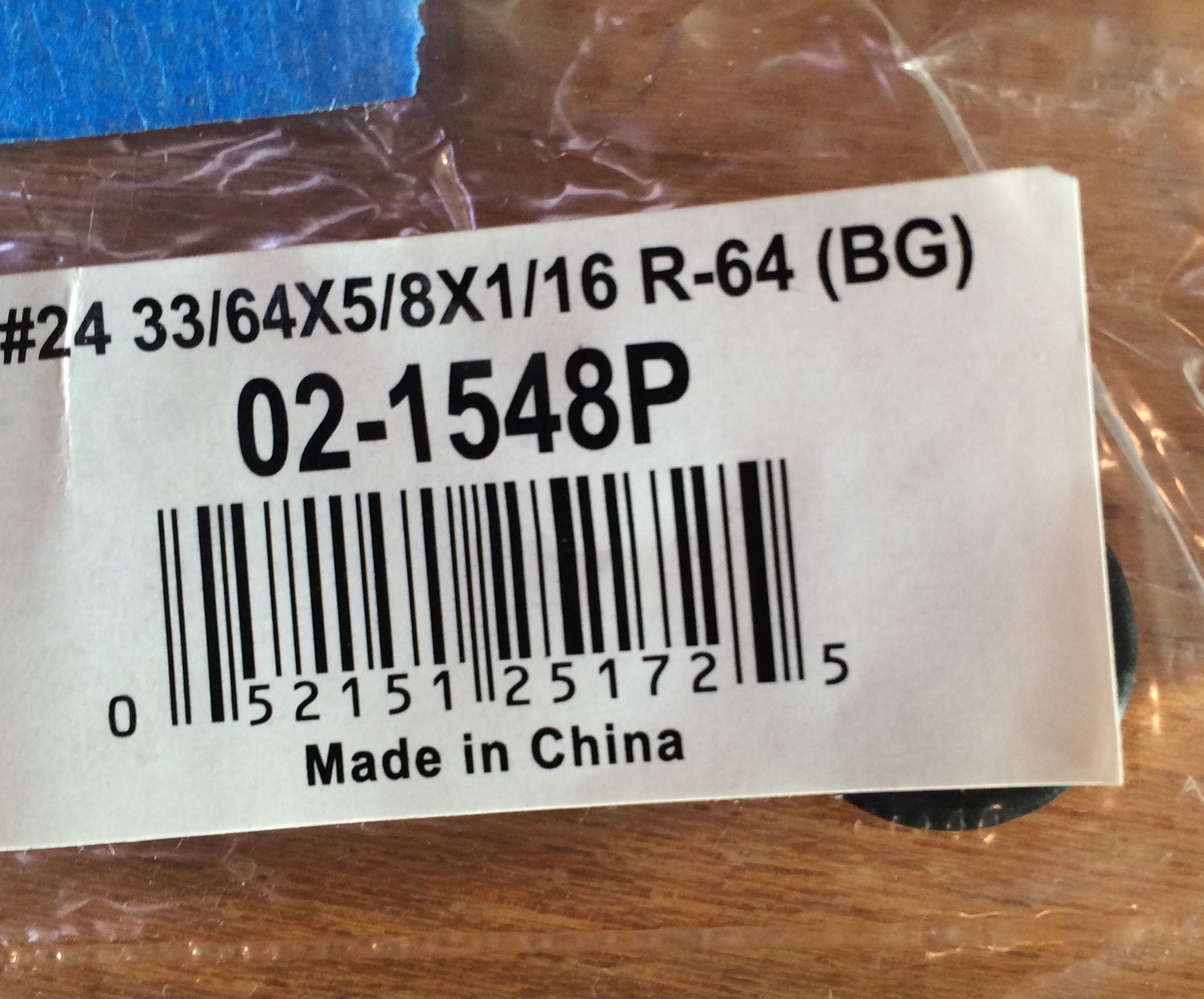

 We had two leaks coming from the port window dogs and so I bought the ​Lewmar Drip Stop Kit from Catalina direct part #Z2854. The Kit has several O-rings and some super lube. The O-rings worked great, 2 years later with record 2020 rains here in Seattle two other dogs started leaking but the O-rings did not stop the leak. I went to our local hardware store and found similiar O-rings but 0.07mm thicker. They Worked! The O-rings that worked were #24 33/64 X 5/8 X 1/1

Thank you for that info. I have been dealing with this "O" doing and leaking dogs to the point that I'm ready to pull the trigger on new Lewmar portlights. So very frustrating. I've placed an order. Thanks
