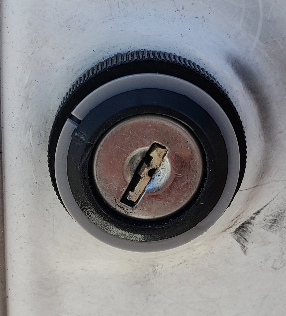

So the maiden voyage with the family was very memorable, for many reasons. Mostly because it was my kids first time on the boat, but not 5 minutes aboard, my 8 year old brushed his knee across the ignition key, snapping it cleanly. (key sticking out the side of the pedestal dies not seam like the best design). The engine was running at the time so the key was in and in the ON position. I didn't have a decent tool on board to attempt to extract it so I left it in and we sailed.
I have a spare key, so if I can get a tool to grip the 1 mm nub, I'll be all set. But I don't think there's enough nub there, so maybe a new ignition barrel? Before I attempt this, does anyone have any advice? See attached pic.

Put a drop of Gorrilla glue on a popsicle stick....or something similar, as it becomes tacky touch it to the key, after a miute when it dries you should be able to pull it out.

 I had that happen on a lock several years ago. First get the switch to the off position so the key can come out. A common way to extract the broken part of the key is using a thin jig saw blade that you've snapped in half.
Using the broken end of the blade, slide the blade into the cylinder above the broken part of the key, twist and pull - Making sure the teeth on the blade are pointed toward you so it can pull the remainder of the key. A little WD 40 in to the cyclinder usually helps. Two sharp dental picks, one on each side of the broken key part will usually work as well.

Worse-comes-to-worse (as it often does), you can replace that ignition switch easily enough for under $30.  Catalina Direct sells both the plastic and brass-bodied switches (​https://www.catalinadirect.com/shop-by-boat/catalina-36/electrical/breakers-switches/), but any Amazon or auto-parts sites also have them.  The replacement is a breeze from the inside of the engine control box, just three wires and little screws.  The sun destroyed the plastic body of my original equipment switch, and it final came apart last year.  The replacement was much easier than I expected.

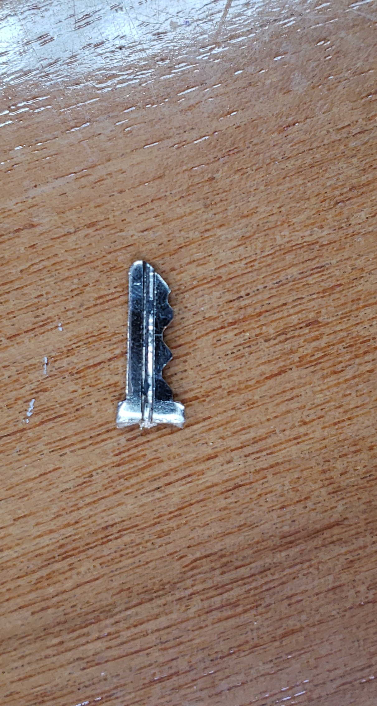

**SOLVED** Took the outer retainer ring off which let me hold the outer barrel with vice grips while turning the inner barrel to off with pliers. Then I used a couple of pieces of staple (found in the bottom of my tool box from who knows when), made curly cues on the end so there was a head to grab with pliers, and slid them in to the grooves. With some pressure the key nub slid out a little, enough to grab it with my needle nose.
