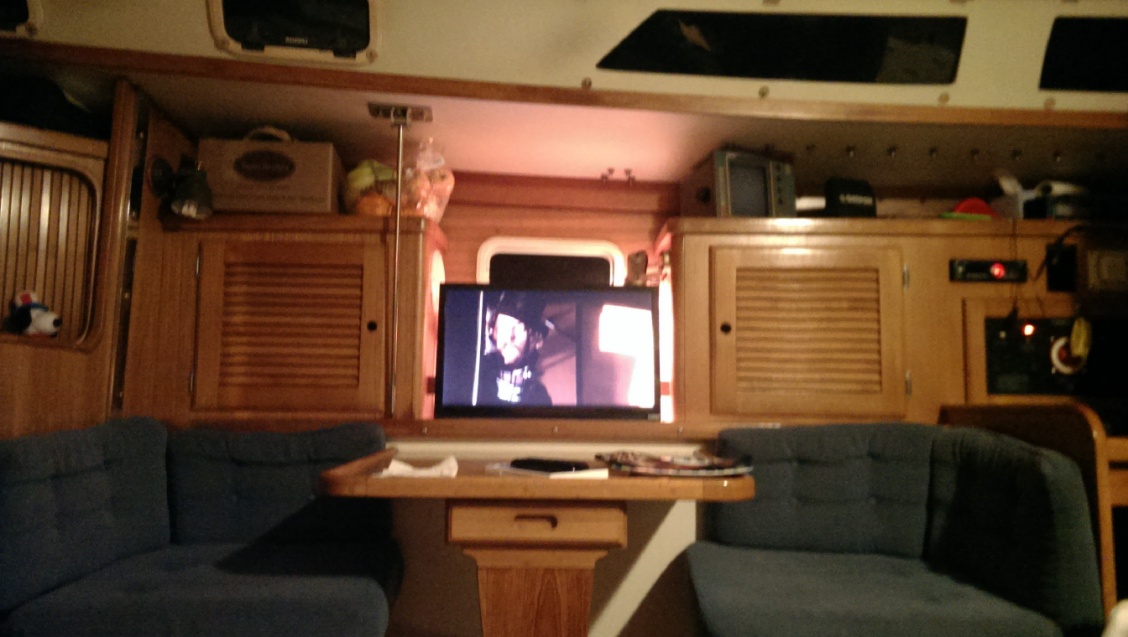

We recently bought a vizeo 24 inch smart t.v. that actually gets its signal from our cell phones. Plays Netflix, Amazon Instant Video, Hulu, etc in HD...and again, the signal comes from our cell phones' wireless hotspots! Also, it props up on a stand that extends out of the bottom of the set, which also happens to fit almost perfectly under the little cross beam that extends across the magazine/book rack just under the starboard light and just above the card table (for those who can't see the picture). I just wrapped a Velcro strap around the end of the stand and the crossbeam and it holds it perfectly still under sail. I believe it is (or at least was) the smallest smart tv of its kind, and it works awesome...and all for just under a couple of hundred bucks :)

That's where our 24" LCD sits as well. Very handy for the evening pit down movie time.
