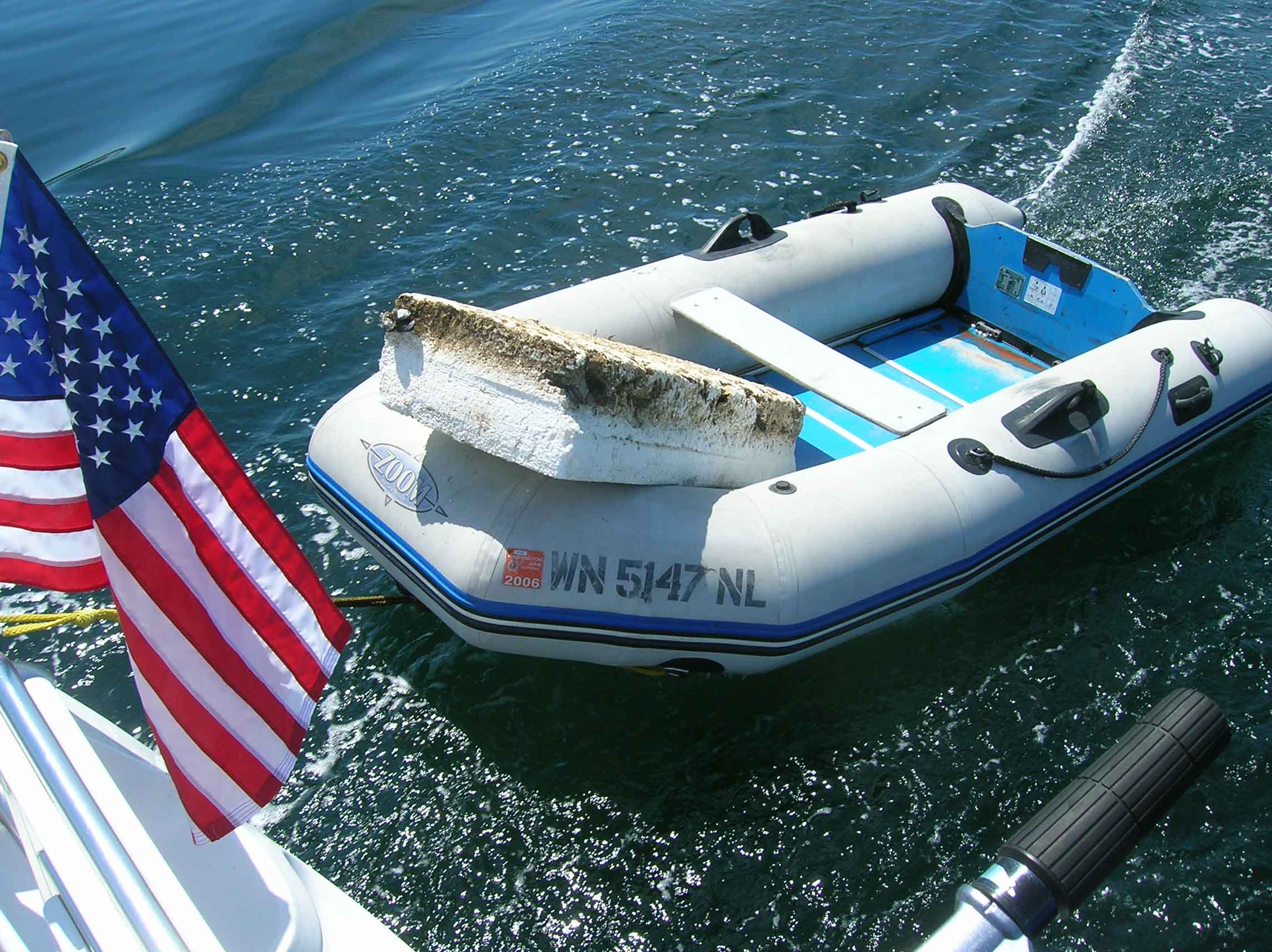

Fred, I tow my inflatable dink only when the sea conditions and winds assure me that it won't go airborne. I had this happen once, on a training cruise...the winds flipped the dinghy, then the "vacuum" created by the sea undulations plastered the upside down dink firmly to the water, the tow rings and handles ripped from the dink, and then we had to chase it down and retrieve it.
But I agree with you, I don't like it on the foredeck. If I must carry it there, I tie it securely, bow forward and bottom up. On the foredeck it smells up the V-berth, makes the V-berth very dark, obstructs the forward hatch as an emergency exit, gets entangled in the jib sheets, and impedes access on the foredeck. Fortunately, conditions that force me to carry the dink there are relatively rare in the Pacific Northwest.
In a few weeks I will be taking High Flight north again for the summer, from Portland to Puget Sound, and as is my offshore policy, the dink will NOT be onboard. I'll drive it up later.
When I tow the dink, I have the painter tied fairly short...the dinghy bow riding no more than 2 to 3 feet aft of the stern. This "short scope" has a number of benefits: it controls the dink better, preventing premature flips, I believe it to be more economical, and importantly, it makes it less of a nuisance when backing out of a slip in confined quarters. (Pssst, don't tell anyone, but I have actually climbed into and from the dink underway, because at C36 cruise speed and with the bow-high angle of the dink, opening the drain plug will empty the dink in short order. Significantly, I had competent crew aboard the mother ship while I was doing this.)
See photo taken underway, showing the distance aft at which we tow the dink. What you see in the dink is a large piece of styrofoam that we came across in south Puget Sound. It's our policy underway to occasionally "help the environment" by retrieving significant flotsam, and then getting rid of it in the next marina's dumpster. It's kind of a practice crew overboard...circle back, extend the boat hook and "stab" the "victim"...hey, just like the real thing.

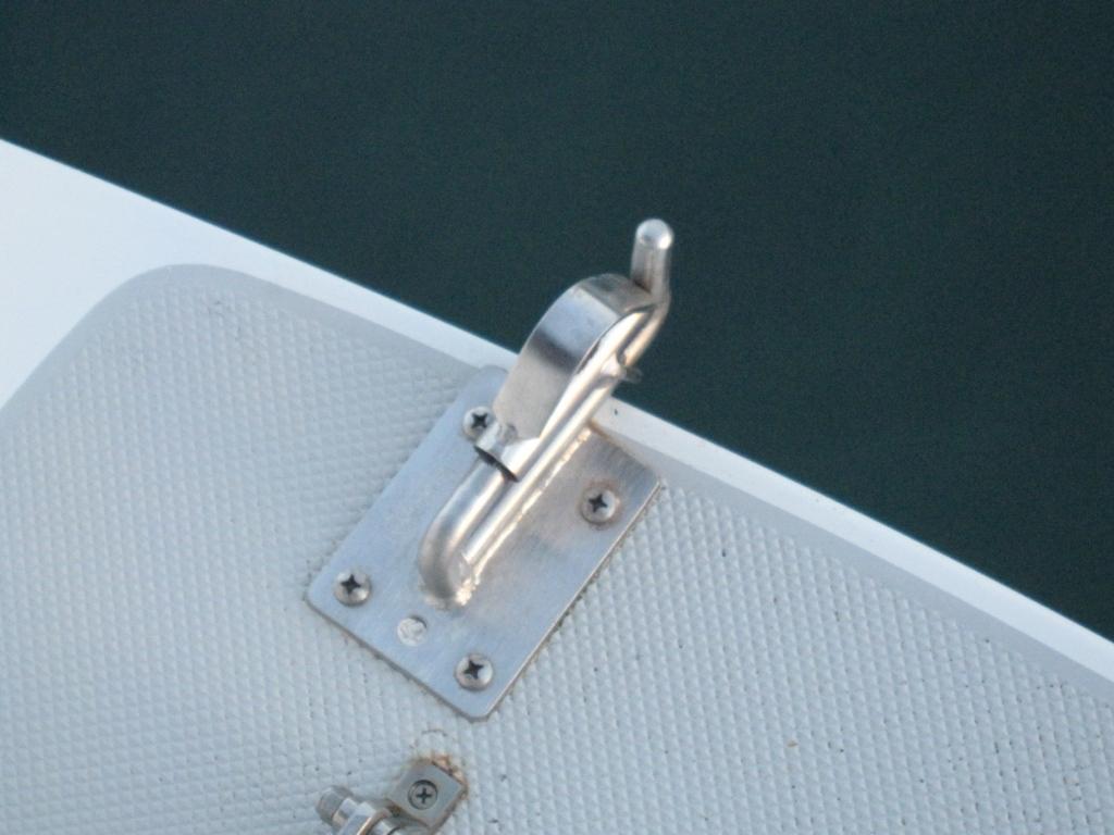

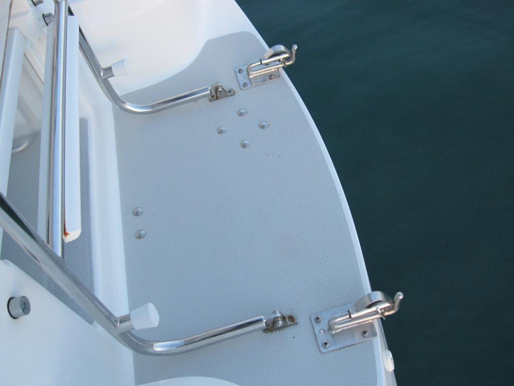

As requested, attached are the photos of the Weaver Snap Davits on my boat.
They are simply bolted to the transom as you can see. It is necessary to glue two yokes onto the dinghy sides, the glue is permanent. I changed dinghys and was able to by spare pads only, keeping all the other fittings.
I don't have a photo of the dinghy lifted into position but there are plenty in the Weaver Catalog. I can't imagine a more simpler or convenient method of stowing the dinghy.
Hope this is of interest.
Peter, that setup is sweet. Presumably you tie a line to the stbdside of the dink and just tilt it up into the stowed position??? The installation doesn't look difficult, either on the swim platform or on the inflatable dink. This arrangement would solve so many problems, and at a reasonable cost.

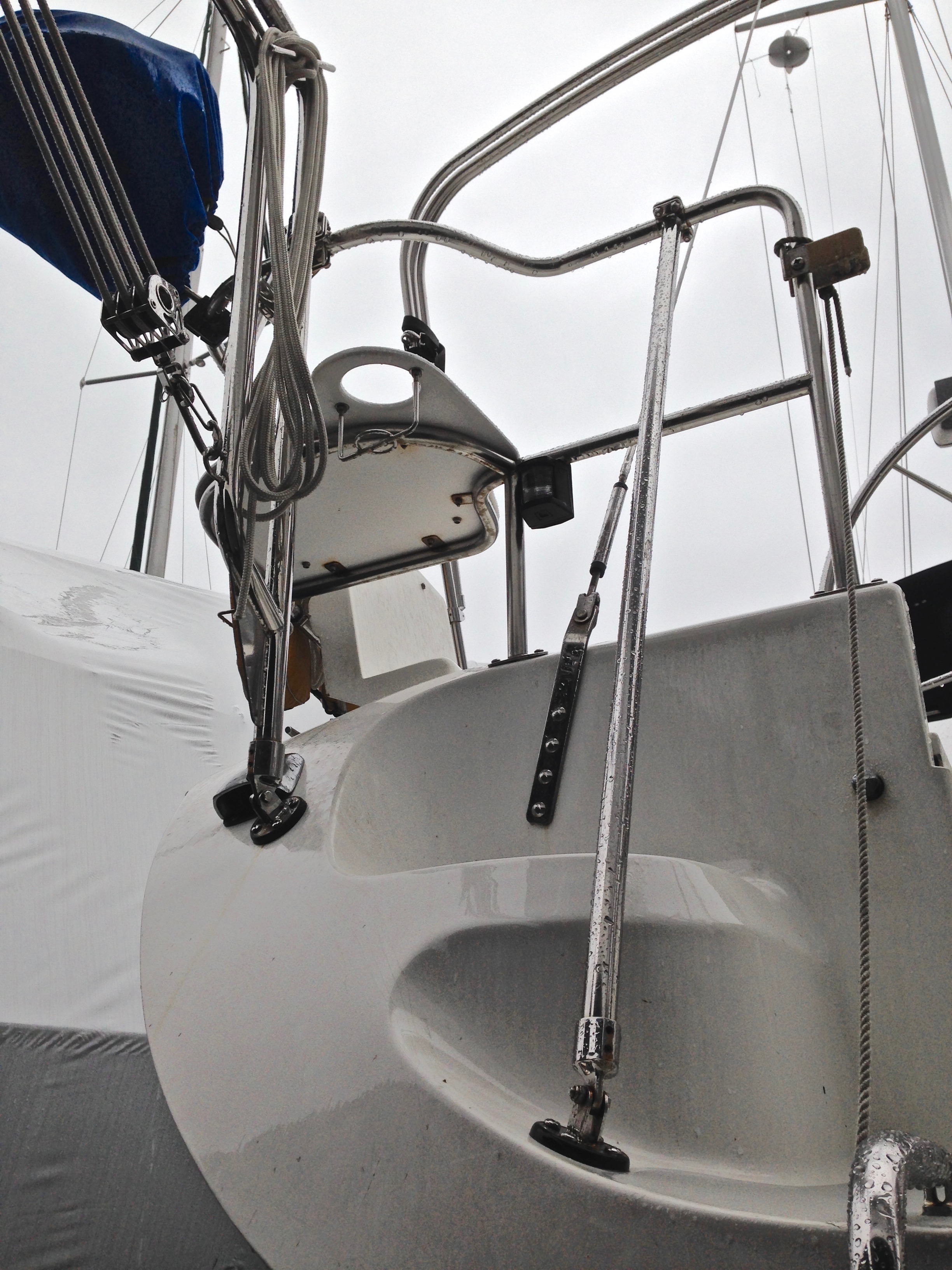

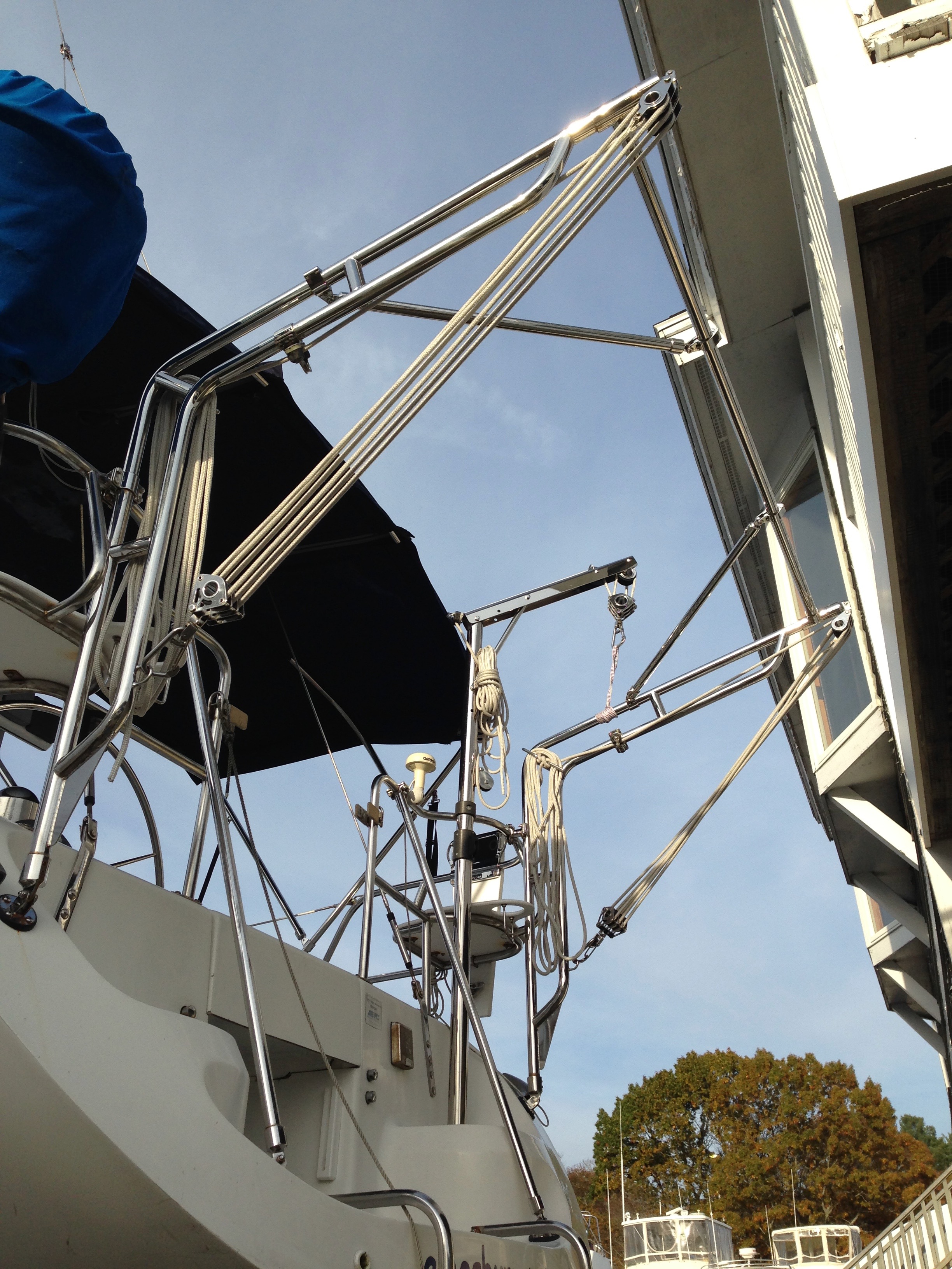

Attached is picture of Garhauer davits (Model DD 6-2) (an engine hoist is also in the picture) mounted on a 2001 C36MKII. Fortunately, this boat was local to me and I had an opportunity to meet with the owner. His 2001 boat has a different stern rail configuration than our 2005 (in the seat areas), but I will still be able to utilize these davits. I'm not sure about the configuration of your stern, but maybe the picture is helpful.
I will document the project when the wheather warms. I do have one additional challenge; the boatyard has our boat's stern pushed very close to a bulding which gives me limited work access.
Posts: 741
I've managed reduce the file size and attach the davit pitcture would not attache to an earlier post
Image icon C36MKII Davits1.81 MB
Posts: 741
One more davit image showing support for stern rail
Image icon Davit support arm.jpg1.69 MB
