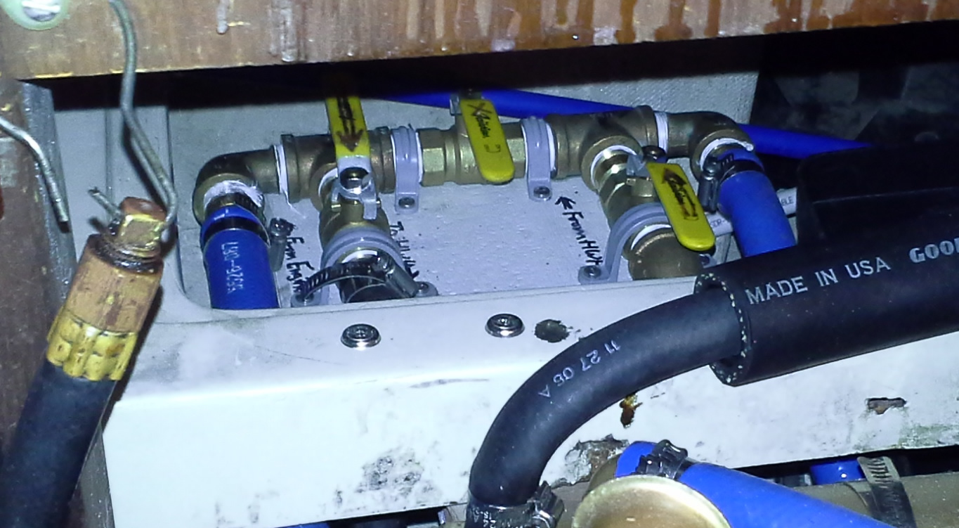

Did the by pass thing last year after having the original gate valve system fail and cause overheating... I fastened the ball valves to some starboard material and hinged it so I could get underneath it to access the packing box and other things in the quarter berth. Flow direction and hoses are marked. To bypass the Water heater turn all valves 90 degrees. Attached is the best photo I have. It is still raining in eastern canada and there is no inspiration to go out to the boat and get ready for launch in two weeks..... three weeks late.:(
