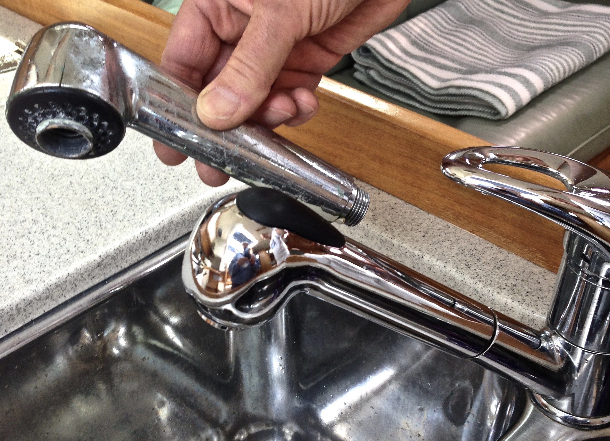

Our galley sink faucet had peeling chrome and cracked plastic on the pull out spray neck. The faucet base and all the other parts were in great shape though. A new complete replacement from Catalina Direct is about $244. I didn't want to purchase a whole new unit, when all I needed just the spray neck. It turns out that the Glacier Bay Laundry/Kitchen faucet # 886 323  ($20 ebay, $39 Home Depot) has a pull out neck that is a perfect replacement for the the Catalina OEM unit.

Hey pkeyser - I know you posted this info several years ago but I now find myself in the same ‘boat’ (pun intended!).  Quick question — does the Glacier Bay sprayer arm have a little ‘nub’ that fits into a notch on the faucet base for stability?  Sorry about my lack of technical terminology!
