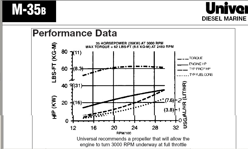

Here is a copy of a diagram I copied from the spec page of the engine. Shows HP, Torque and fuel consumption per RPM.
Interesting that they just graph it to RPM regardless of load.
It looks to me that at a steady 2300 or 2400 rpm you are going to get about 1 gal. per hour. If you spend a certain amount of time like I do just idling and at slower rpm when in the marina and docking, then your average will go down. I seem to average around .8 gal/hr which includes some longish trips. I have an Autoprop which seems to be somewhat more efficient.
