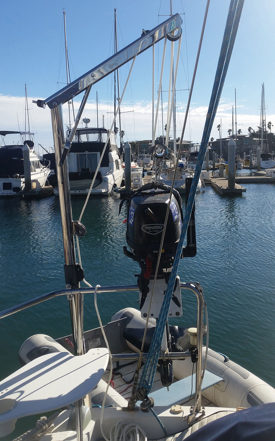

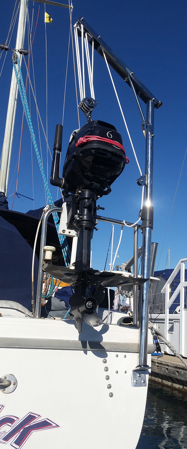

Engine Davit Installed on MK I
Hello 36'ers
​I am sending along pictures of my engine davit installation for the MKI folks. This is an awesome edition if you race and cruise your boat. Adding the bracket to the transom is a two person job. Otherwise a very simple install. When we race the crane goes in the dock box and the motor goes in the back of the car.
When I first searched this forum I did not find any pics of the completed install that matched my situation. Soon we will be headed to Santa Cruz Island and working this crane out.
Have a wonderful and prosperous new year!
Capt Bill
1989 MK I Fin keel std rig #1015
