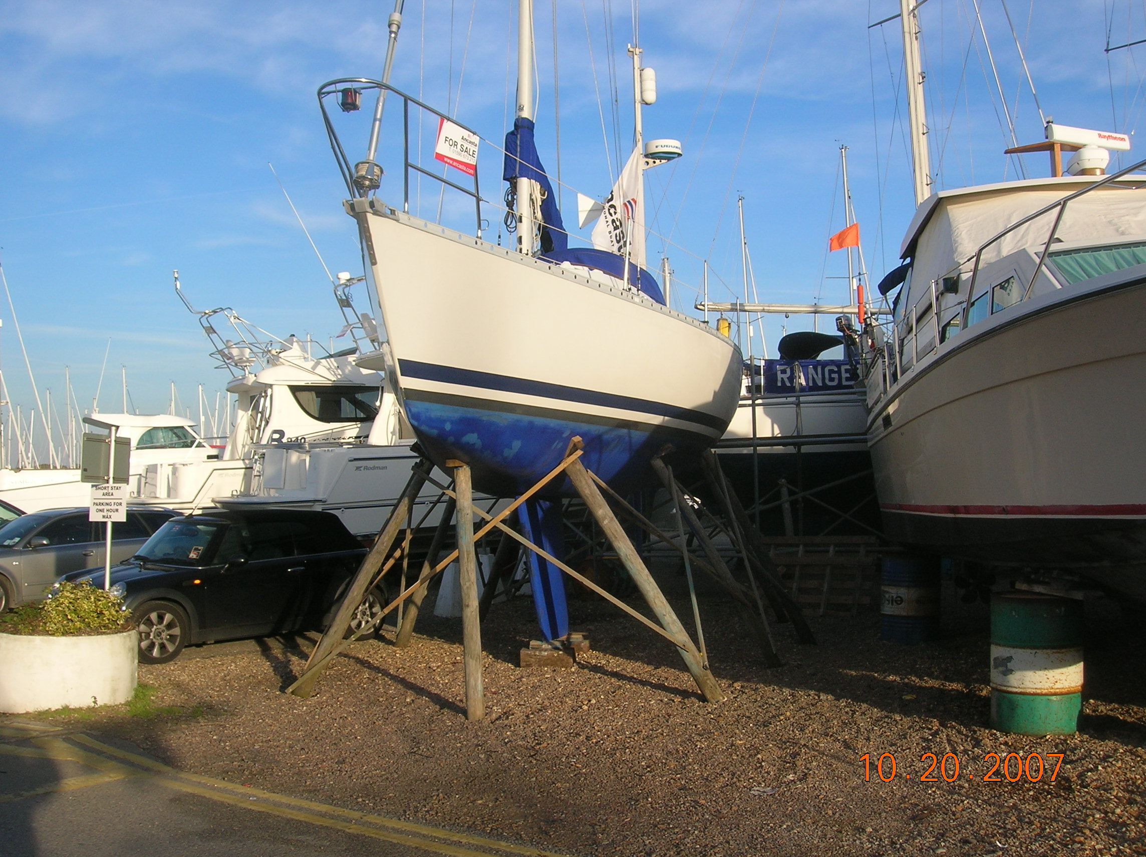

When I was over in England, I saw some very unusual sailboat support methods; basically logs replacing jack stands and held together with small sticks. Hope the photo file size is small enough so all can see it
