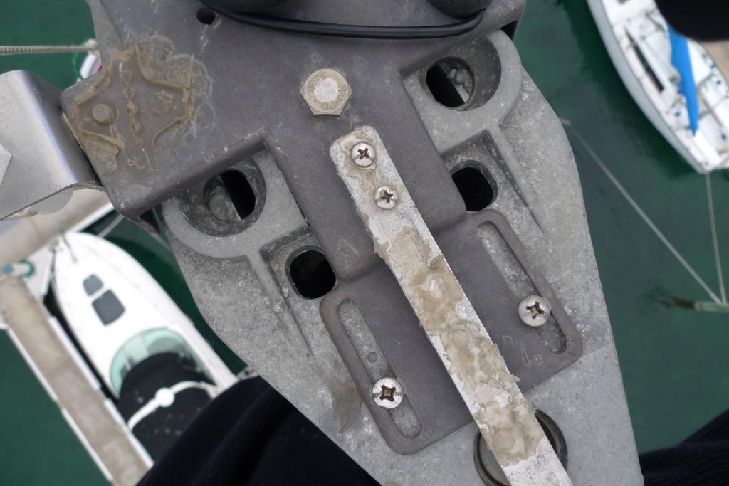

Over the years, one of the biggest frustrations of owning my C36 has been the constant water in the bilge. While I have pumped and sponged it dry many times, the water returned, eventually turning slimy and causing rust the appear on the exposed keel bolts.
On this and other forums, there have been numerous causes proposed. The most obvious is water entering through the mast via the roller furling slot or the mast boot. (No water enters from the prop shaft as I have a PSS  seal). Solutions have been proposed such as plugging the interior of the mast with foam, clearing out the drain hole etc, etc. On later Charleston mast sections, the mast is actually sealed at deck level below the drain hole under the roller furling screw.
Another cause is overflow from the water tanks which when overfilled  leak into the bilge - this is easy to fix if the tanks a aren't overfilled. Some owners have used sealant around the inspection ports.
However, in my case, the culprit has been rain water entering via 4 holes at the masthead as shown in the attached photo. Water entering here has made its way down the aft  inner cable conduit to the bilge. To stop this I simply filled them with silicon and my bilge has been perfectly dry for months despite torrential rain at times.
looks great - I still have a few gremlins to go --

Can you come do mine?  I got vertigo just looking at the photo!

My question is why are the holes in the top of the mast. I would think if Catalina went to the expense of making the holes there they would be needed for something?

Not sure what purpose is. Possibly to allow access to inside mast and conduit tubes.Mast sections and castings are made by/for Charleston so not necessarily a Catalina specification.

Well done in hunting that down.  I filled mine with some spare butyl tape the last time the mast was down.  I'd still hunting the last few leaks as the PSS dripless shaft log has made it theoretically possible to be dry!

I got up the mast today, ready to cover the holes up top....only to find out the top of my 2000 Catalina 36 has a solid plate up top, and no holes to cover.  FYI - the plan was to use butyl tape to secure thick plastic covers, to be cut up top the mast with a Craftsman cutting tool.
