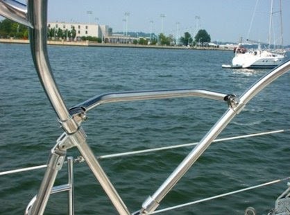

Chuck -
Just FYI, our dodger handrails were installed right after we bought Tehani in ​Maryland. They are mounted in holes drilled right through the canvas and dodger frame. At first I was upset, as this looked lazy and less than ship-shape. However, after five years, they look like the day they were installed, with no fraying of the canvas. We consider this perhaps the single best upgrade we've done on the boat!
