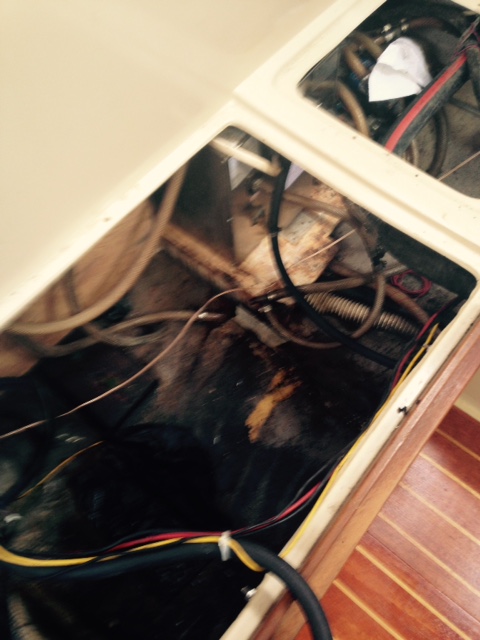

A year ago when I bought the boat Hull 239 I had residual  diesel in the bilge.  Not a lot diesel but a scrim.  I have replace all the fuel lines and components except the return line.   I have placed absorbment mats under the engine, transmission, the fuel filter area.  These all are dry.  The bilge is dry except when it rains and come down the mast. When that happens the scrim show up again.  This is not a lot of diesel but show huge win the pumpp get on and empty's out.
Any ideas where to look?

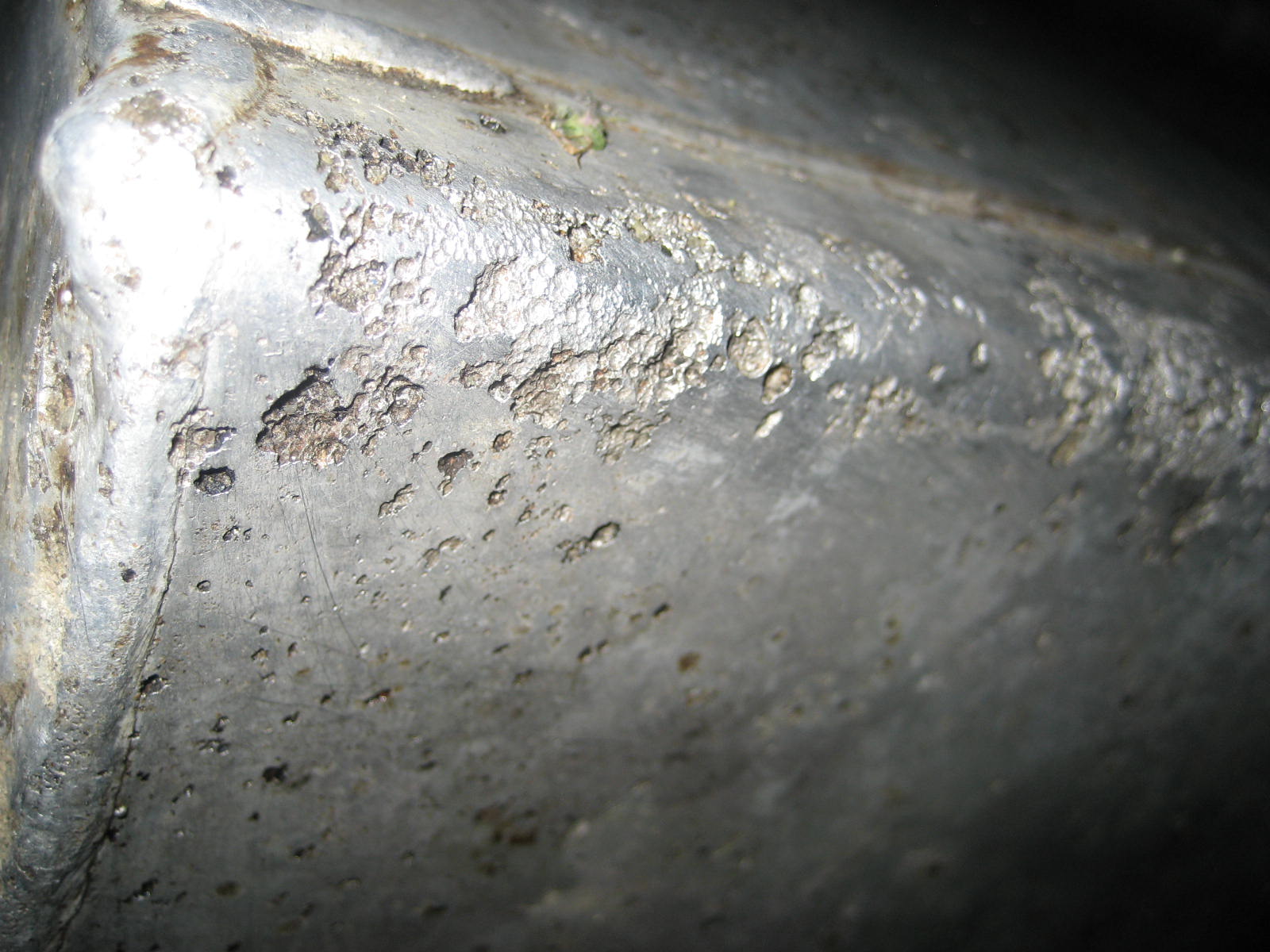

I'm not saying this is where your fuel is coming from.  It was just my experience.  Once I got my fuel out of the tank, I could see down inside and it was nice & shiny.  I was so happy.  Until I pulled the tank out and scraped the bilge goop off.  Here's what it looked like.  The holes were minuscule, really only showing the fuel leaks when left to sit on a paper towel.

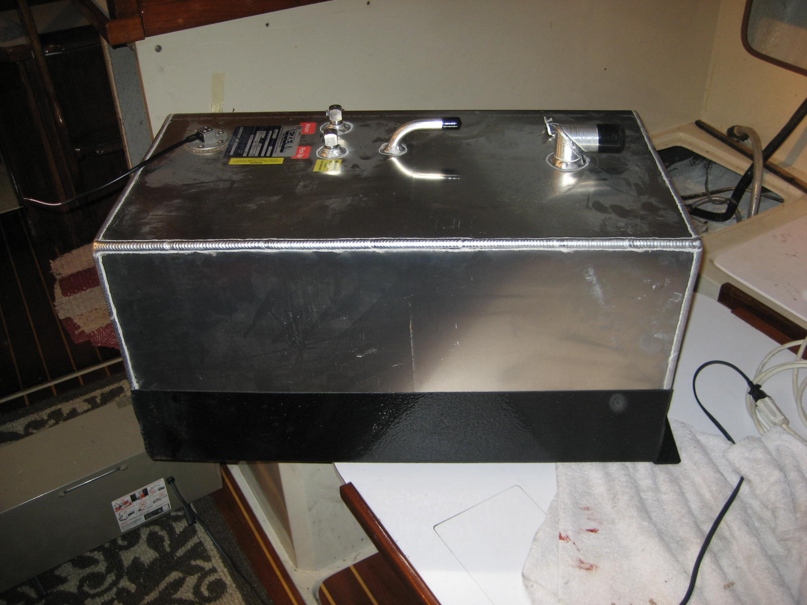

The new tank from Catalina Direct, is rectangular, rather than tapered like the OEM to follow the hull down to the lowest point, (thus sitting in bilge water).  I had the new tank Rhino coated, and it sets on a piece of pressure treated 4X4 cedar at the bilge lowest point, so the top of the tank is level and the bottom is out of the bilge water.

Here it is before install with the new Rhino coating.
Unlike me, you'll have more money left over for other things :-)

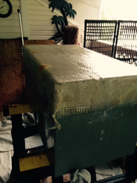

The damage to the tank was similar to what most of you have experienced.  I then used my palm sander and 60 grit paper to sand the bottom and score it up so the epoxy had a good surface to bond to then I cleaned it with acetone.  I then laid down a coat of epoxy then applied the mat using a fiberglass roller to roll it in to get it well saturated then more epoxy, then the roving and more epoxy.  I went 8" up the side and end to make sure all welds and corners were covered.
I have uploaded some pictures for your review.  Total cost about $30.00

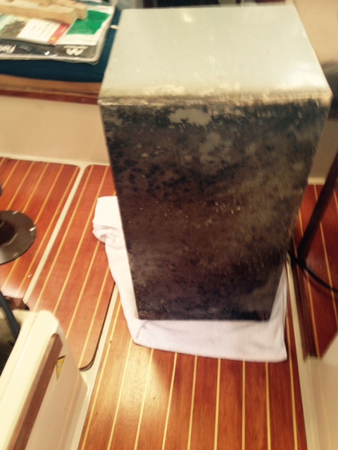

If you look at the pictures I posted the tank is sitting on a old bath towel on the floor.  I used the towel to slide the tank over to the stair.  I covered the stairs with bath towels and the companionway.  I lifted the tank up to the top step and set it down.  It just fits though the companionway.  So I just tilted it out into the cockpit.  I just reversed the process to return it to resting spot.  I did do extensive cleaning while the tank was out.

Anyways, there's a high spot on the hull that I am concerned with touching the tank.
Actually that might not be a problem for you as the new tank is rectangular, not tapered to follow the bilge like the OEM.   You will need to prop up the one end by the keel bolt so that the tank sits level.  I used a piece of pressure treated 4X4 cedar that I had.
After spending $$ on a new tank (as I did), you might consider having the bottom 3rd Rhino coated.  It's the stuff they coat pickup truck beds with.  It's tough and looks nice on your new tank.  See pic in my post above.
