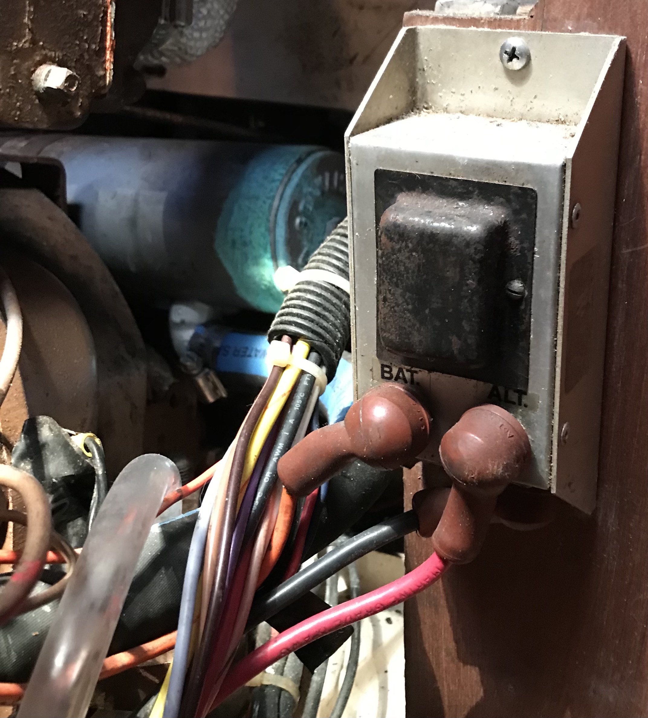

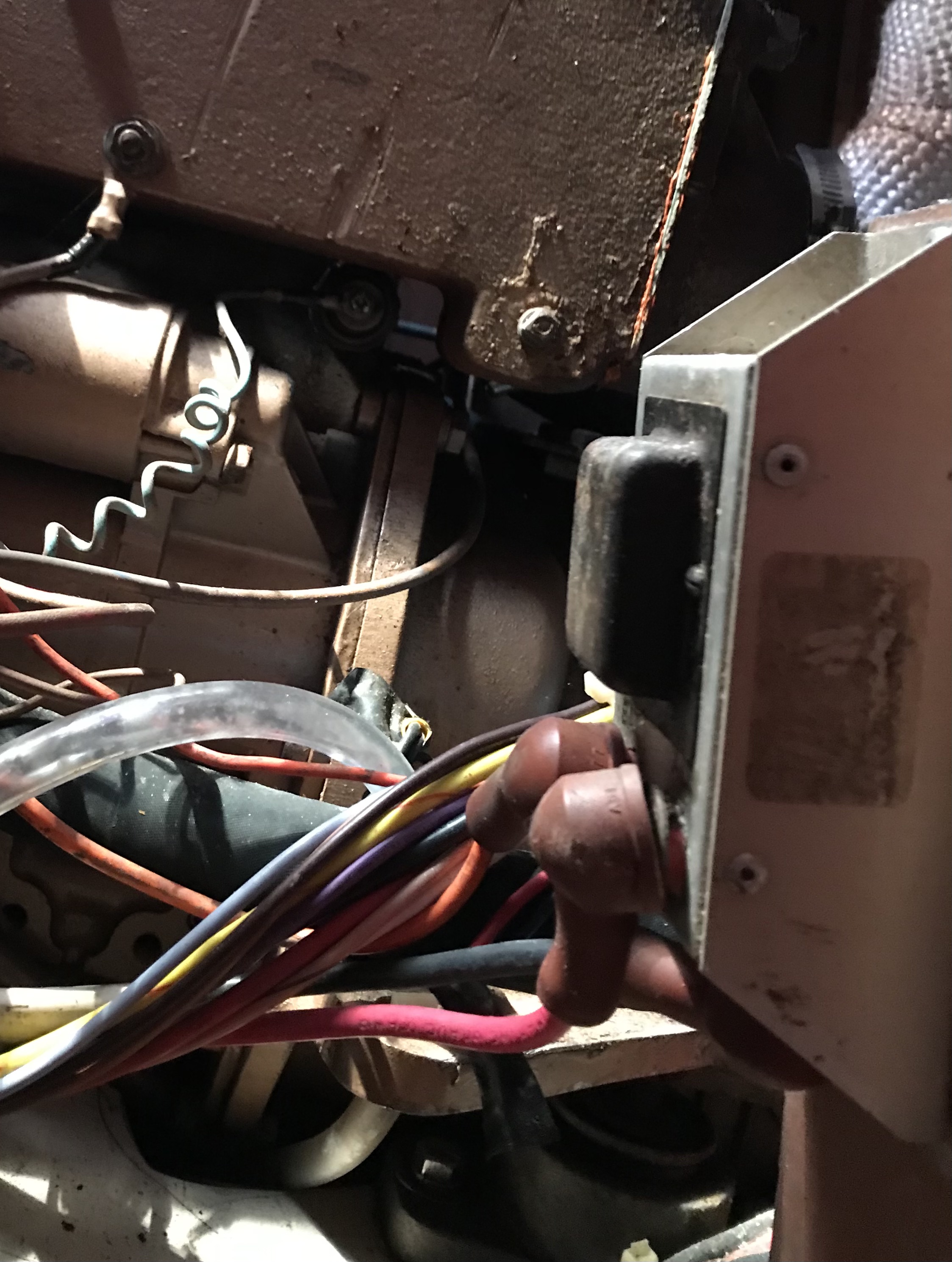

DC charge system what is this part
Boat is a 86 cat 36 so it has had a few monkeys that have worked on things.
So it's time to redo the battery cables
it appears that some one didn't use tinned cables corrosion problems.
and plan to set it up for lithium house and lead acid starting only battery
My problem is I'm not sure what this is in the pictures, is it a battery isolator or something else

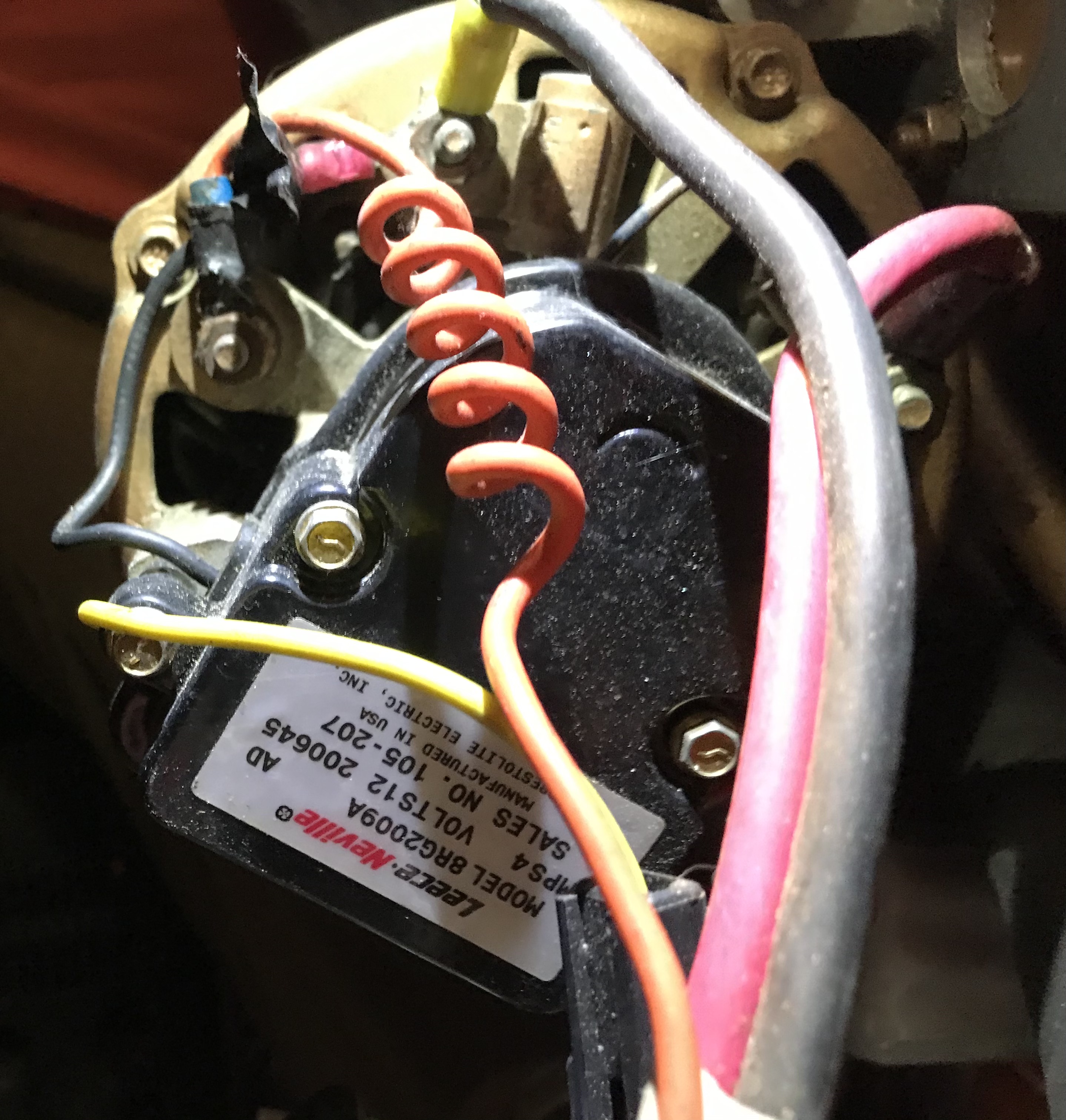

third one is the back of alternator

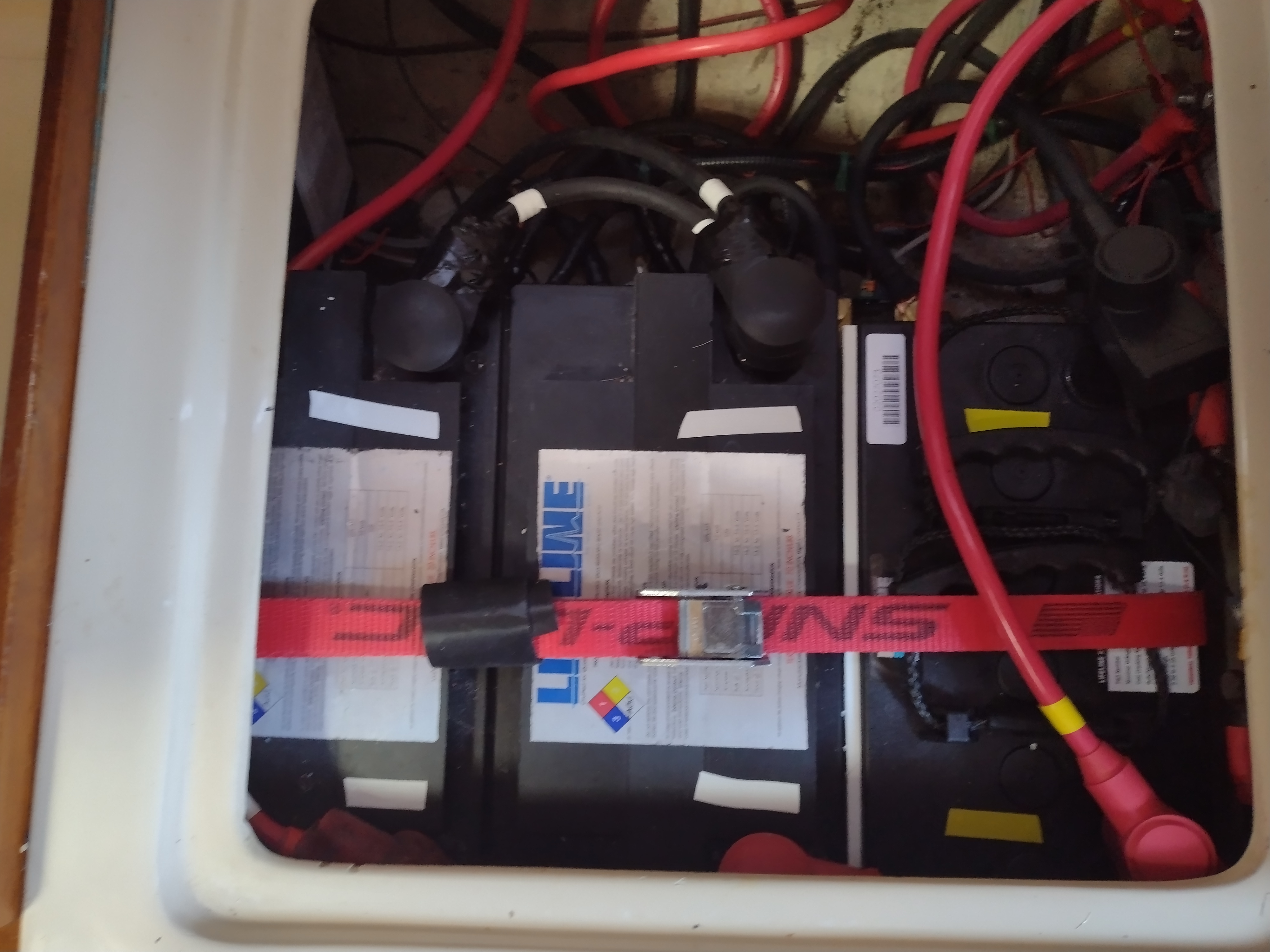

Larry,
I have 3 batteries in the seat locker in front of the Nav. station.  the Inverter charger is in the seat back storage immediately above the batteries.  The second set of batteries is under the outboard dinette seat.  I helps move some of the to the other side of the boat.

True Wind
Joined: 7/15/12
Posts: 148
I'll take a stab at this. The black piece sticking out a bit looks just like a transformer. From my observation of the photo you have three wires going to it. One from the alternator, one going to the battery and one ground. It's an alternator noise suppressor. I was wrong once back in 1956 but later found out I was just a simple mistaken. Whatever it is, I'd get rid of it.

Siler Starum's picture
Siler Starum
Joined: 4/20/18
It is a voltage regulator

True Wind
Joined: 7/15/12
Posts: 148
Initially I thought it might a voltage regulator too. But the alternator has a voltage regulator on it. Why would there be two?
2003 Catalina 36
Booker Sea
Joined: 11/22/21
Posts: 11
Kind of ruled out a regulator given it's on the alternator,
I am assuming that the alternator actually chargers.
 previous owner was a invoice keeper, but no indication from that
appears to be at least pre 2009
Booker C
1985 C36 MK1
