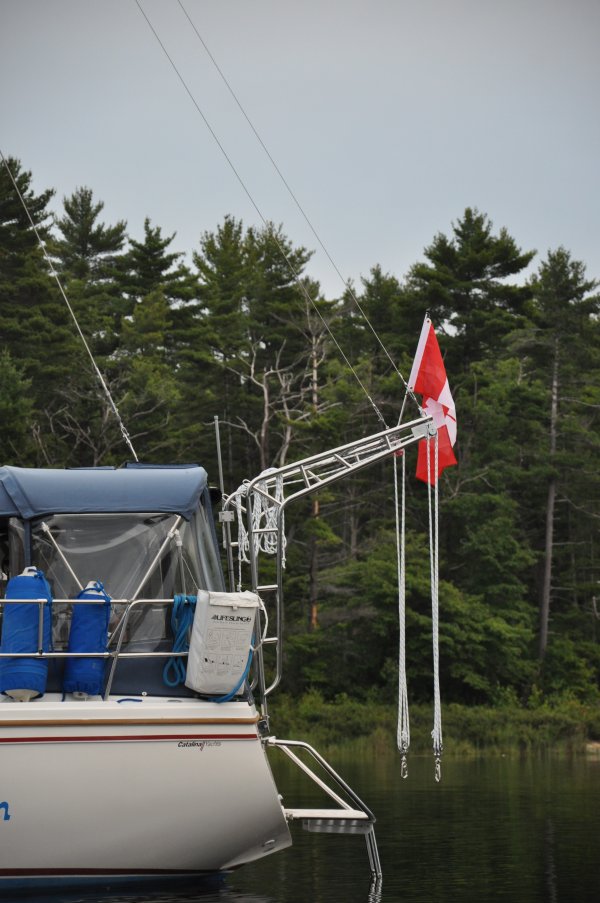

I had a set of davits made up by Stainless Outfitters in Barrie, Ontario. They are 1.25" dia tube. The base bolts on the transom and special clamps attach to the top stern rail. If you look at the attached picture you can see that I also added two 3/16" 1 X 19 stainless cables from the outboard end of the davit up to the mast head. This helps carry some of the dinghy load. There doesn't appear to be any negative effect on mast rake with the dinghy attached.

Larry please don't even consider it unless motoring in glass calm. Davits should NOT be used in rough weather even with a light dinghy. We have had them on three boats now and I have seen a number of failures due to the dink being left on in rough weather. The forces exerted on the davit system in rough weather, even with a 100 pound dink, are tremendous. If you can't stow the dink on the bow, lashed down, it's simply to big for the boat.
Our davits are basically used as a dinghy garage for when we are on the mooring. It keeps the growth down. We rarely sail with the dinghy in the davits, ours weighs about 100 pounds, and prefer to tow. If it gets nasty the dink is upside down lashed on the fore deck..
